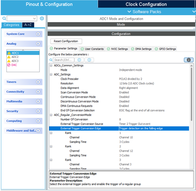

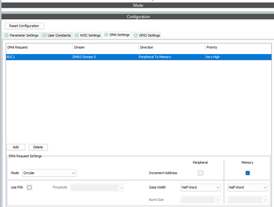

Hi Iam using STM32F407 discovery board and iam trying to sample 8channels of an ADC. Iam trigerring the ADC with a timer and Iam also using DMA whitch interups the code when the DMA buffer is full. Timer freq is 12kHz. DMA is in circular mode.
Problem is that when I have the sampling time on the channels set to 3cycles, it works fine and the adc channels are aligned correctly in the buffer. But when I increase the cycle duration the chanels get shifted in the buffer so in the first 8 positions of the buffer the 8th channel is not in the 7th place in the array but in 4th. When i set the DMA to normal mode and start the DMA in code the shifting gets randomized everytime the DMA is started. Can someone tell me what the issue is? I ran out of ideas. The values around 2000 are from the 8th channel

And there is my ADC and DMA settings.
