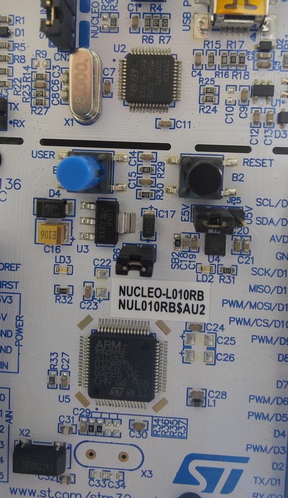

I buy a new board L010RB, but it is labelled with classic strap "NUCLEO-L010RB" but there is one line after with is "NUL010RB$AU2". I had a couple of L010RB before but it's the first time i have such label on it.
I'm wondering what is mean.
Plus I'm having some trouble with SD card / SPI. The card mount, open & read correctly the file but when it writes, it seems that after a couple of writing, it cannot write again in it nor open a new. I'm using FatFS with a code that i used before, and i never had a FR_DISK_ERR after some write.
Could it be linked to the weird label?

  • NUL010RB$AU2 is the Product order code.
  • For the SPI/SD card, I suggest you to look at this post.(video+description step by step).

Ok for the product order code. By looking the left box of my others L010RB, I can saw that they are $AU1.
As i said my code for my SD card works fine on those card and for the $AU2 it can perform several file writing before the FR_DISK_ERR. So, i'm doubting about the fact that I need to remake that work with the fatfs generated code that need to be fix with some blog post 4 ~ 5 years old written in Korean.
Could it come from a clock pre-scaler that need to be change or something like that?
Best regards
