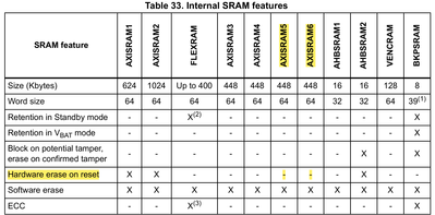

However, it looks like on the STM32N6, the contents of AXISRAM5 and 6 are not preserved across software resets. At least, checking the "magic" header in FSBL always produces randomly looking results that are also different each time I try. Is there a way to preserve contents of AXISRAM5/6 across resets? Do I need to configure something for this to happen (e.g. is there some security feature that resets RAM contents, or the BootROM doing stuff, etc)?

After internal confirmation, this is due to the default shutdown mode of SRAM3 to SRAM6. This corresponds to bit 20 (SRAM SD) of the RAMCFG_AXISRAMxCR registers (with x = 2 to 6).
In RM0486, the reset value of the RAMCFG_AXISRAM3CR to RAMCFG_AXISRAM6CR registers is 0x0010 0000.
As a result, by default, the internal power supply of the concerned SRAMs is turned off to reduce power consumption on VDDCore. Consequently, their content is not guaranteed after a System Reset.
Therefore, important clarifications need to be made on our side in this reference manual, starting from section 10.3.1 "Internal SRAM features" and especially in Table 33 "Internal SRAM features."
Please note that for SRAM1 and SRAM2, the default value of bit 20 (SRAMSD) is 0x0000 0000. However, their content is erased by a system reset.
For your application, you can use the 80kB of retention RAM (between 0x3400 0000 and 0x3401 4000) or the Backup RAM, which is in the VBAT domain (only 8kB !).

AXISRAM5 and 6 are not erased on reset according to the Reference Manual. I would recheck your assumption there. Or perhaps your software is performing a software erase on startup.
Set up a hardware watchpoint and see when and where it's modified during debugging.
That table is the reason I used AXISRAM5/6 in the first place:) However, I'm just not sure whether there are other components in the N6 that erase the memory that I have missed in the thousands of pages of reference manual. E.g. all the security features, BootROM, etc, there simply are a lot of moving parts on the N6 that are easy to miss.
