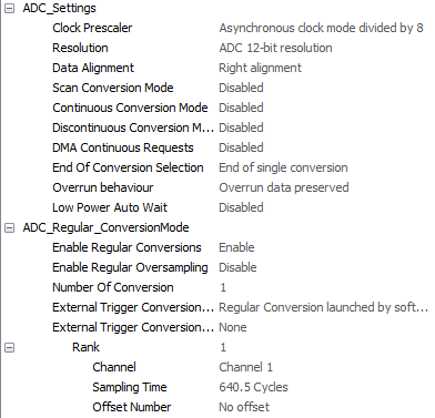

‎2023-11-30 10:00 AM
> I'll post a screenshot (or a few) of my register readouts for ADC1 and ADC123_Common in the original post.
OK so you've posted a screenshot, where ADC_SQR1=0x1C0, i.e. one conversion and that's on channel 7; and ADC_DIFSEL=0x80, which means the conversion on channel 7 is differential.
The mcu does not work out of what you've clicked in CubeMX, it works out of the registers' content.

HCLK is set for 80MHz, ADC settings are below:
