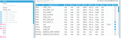

I'm having an issue with my STM32F303RE. I'm using CubeMX to initialize ADC1_IN1 as single ended on PA0, and PWM generation on TIM2_CH1 on PA15. Unfortunately, PA0 will OUTPUT a voltage roughly proportional with the duty cycle of the PWM on PA15, i.e. setting the PWM (again, supposed to be on PA15) to 50% duty cycle results in about 1.5V on PA0. The PWM on PA15 is generated correctly. The PA0 voltage looks like a noisy but constant signal, it doesn't have the PWM signal "shape". PA0 is itself compatible with TIM2_CH1, so I guess something is bleeding over somewhere. Please help me fix this programmatically, I'm really not keen on redoing my circuit.

Which leads me to my followup: how can I check the register values? As I mentioned, the same setup works fine for a different combination of timer/adc/pins, so if anything it's CubeMX messing up the code generation (I'm using the makefile setting and programming in vscode fwiw). The init functions seem to be correct in that all the config information from the CubeMX GUI is carried over to the relevant init functions for ADC and PWM as far as I can see, but I haven't been able to go any deeper than that. Setting the ADC/PA0 pin to RESET_STATE in the GUI does remove the problem.

what you set to gpio etc you can see in Cube, ie:
+ if not trust in this, see the generated code (in source -> main.c + xxx_msp.c )
