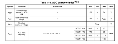

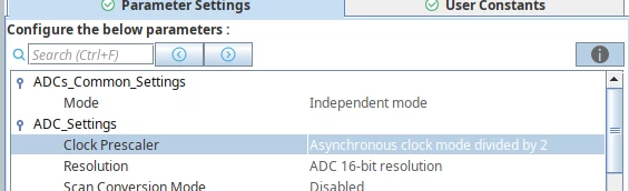

You set the adc clock in clock tree ->
and then choose in adc settings...
+ in ds see the limits :
mo_krautiAuthor

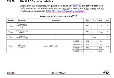

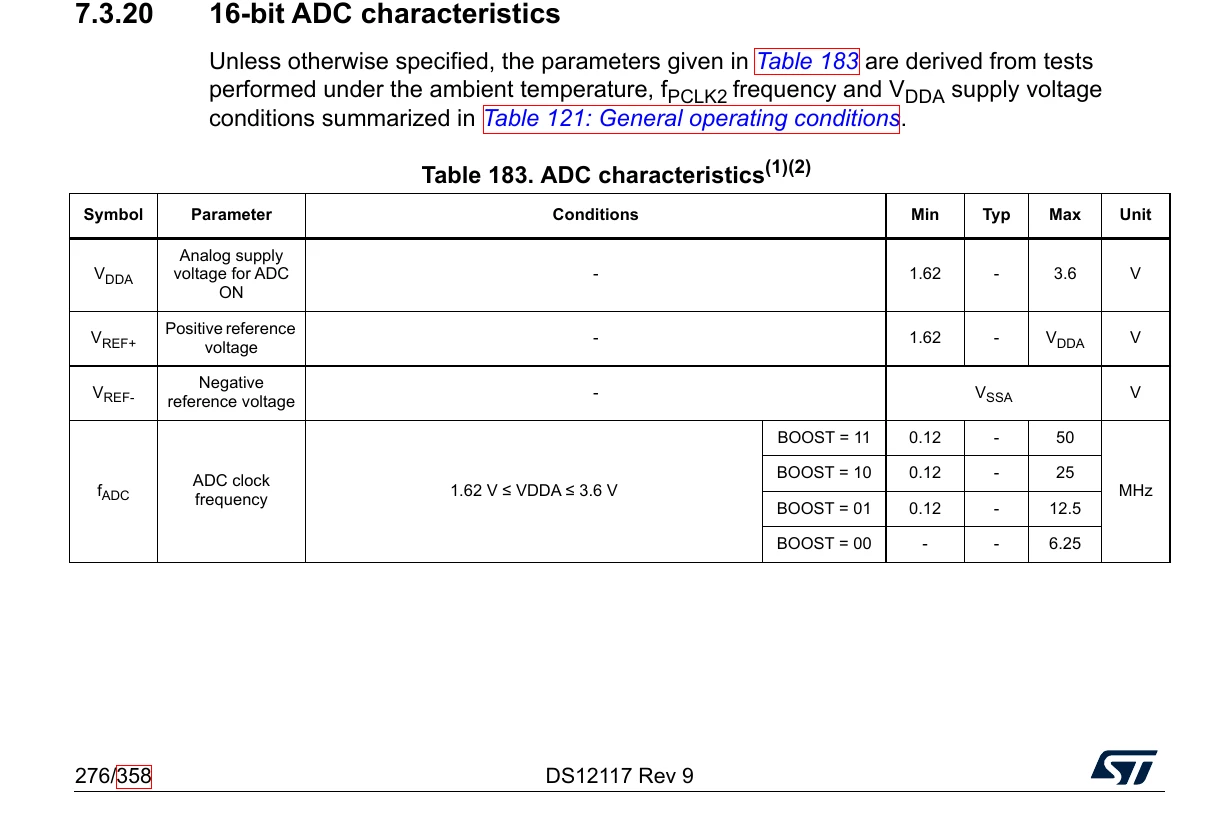

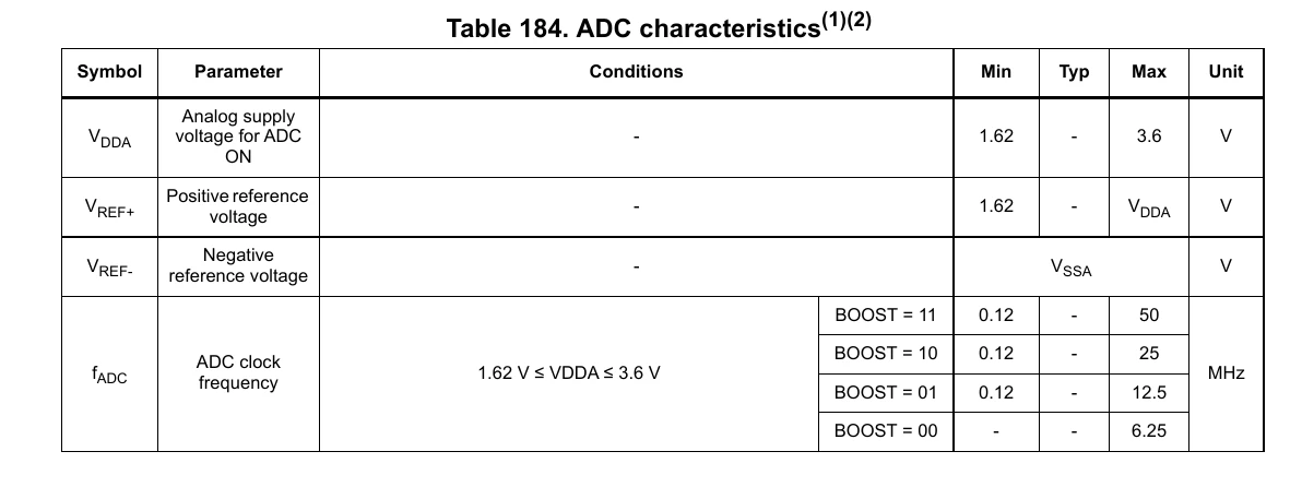

In which document is this ADC table? I looked into the RM, PM and Nucleo 144 UM.
Also I tried different clock inputs (80, 64, 32, 16 MHz) but the error still occors.
AScha.3
May 27, 2025
in ds , as i wrote.
