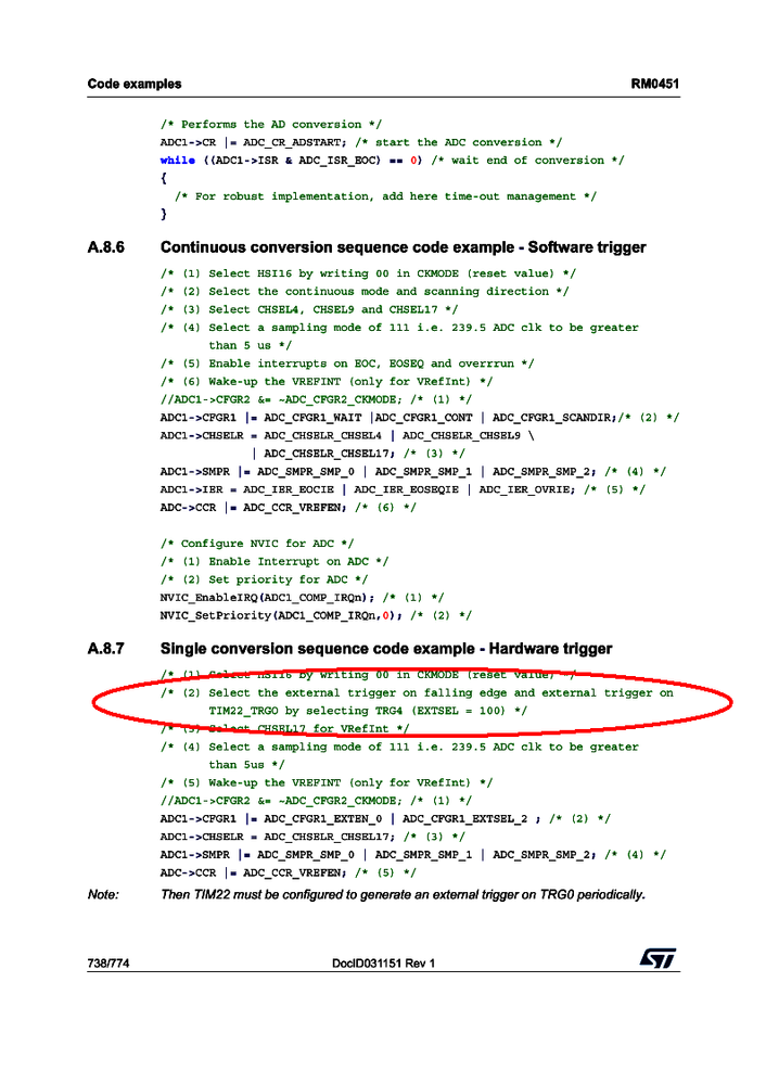

What's the device ID (DBG_IDCODE)?
You can also try to use TIM22_TRGO with EXTSEL = 100
Yes, it appears to be a bunch of bugs and errors in the documentation.
ID code is 0x20186425, so definitely category 2 device.
