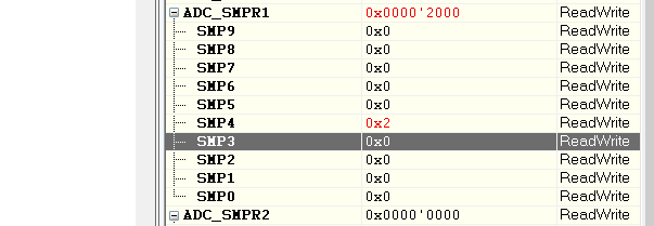

just (you verified most timings perfectly) , did you verify whats in SMPx[2:0]: (Channel x sampling time selection) really is ?
‎2024-07-09 12:16 AM - edited ‎2024-07-09 7:59 AM
i already checked the respective SMP register. Here i set the sample time to 12 ADC Cycles.
The register is set like expected.
Below are the ADC1 registers after ADC conversion start and after end of conversion (EOC).
