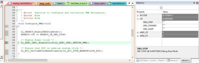

Thank you for the reply @Amel NASRI . I checked the register and yes it was set to 0. However, it still doesn't change after I added DBGMCU->CR |= DBGMCU_CR_DBG_STOP; . Is there anything else I should do before changing this register
