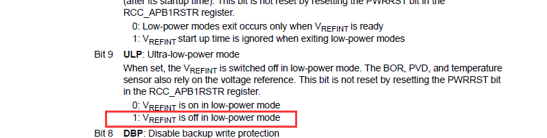

Posted on May 02, 2018 at 10:13
thanks all of person's help, finially, I found the fix. if I enable ultra low power mode, this issue disappeared, although I don't understand the real reason.
HAL_PWREx_EnableUltraLowPower();

JWieb
I just wanted to bump this for the mods.
Has anyone found a solution? In any configuration if we enable ULP, after STOP wakeup the vref seems corrupt.
JWieb
@dz huang
Try disabling the ULP before ADC calibration and enable when you are done with the ADC.
This worked for us:
void ADC_Start() {
 LL_PWR_DisableUltraLowPower();
 HAL_ADCEx_EnableVREFINT(); //Wait for vref to start
 HAL_ADCEx_Calibration_Start(&hadc, ADC_SINGLE_ENDED);
 HAL_ADC_Start_DMA(&hadc, (uint32_t*) &ADC_raw, adc_Channels);
void HAL_ADC_ConvCpltCallback(ADC_HandleTypeDef *hadc) {
 HAL_ADC_Stop_DMA(hadc);
 LL_PWR_EnableUltraLowPower();
