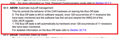

Did you set the Automatic bus-off ?
i.e.:
CanHandle.Init.AutoBusOff = ENABLE;
2024-07-10 11:11 AM
Thanks for your reply, AutoBusOff is enabled. There are only two nodes on the bus and after some period of time (say days), one node is going into error passive (say when TEC exceeds 128). So when the other node requests some data, the second node is not able to respond for a long period of time. This leads to a communication loss. I wanted to know how to reset the error states in such conditions.

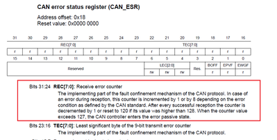

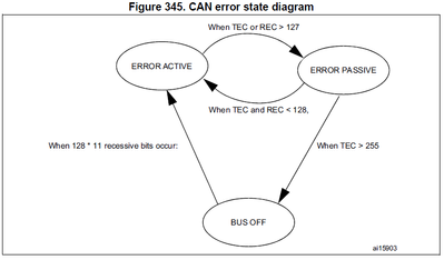

Figure 345:
Page 1108:
As you see TEC and REC counters are read only bits. So you can't reset them by software but you need conditions described in the CAN standard to reset them.

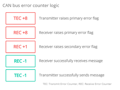

See for example this link https://www.csselectronics.com/pages/can-bus-errors-intro-tutorial#:~:text=Specifically%2C%20every%20CAN%20node%20keeps,if%20the%20TEC%20exceeds%20255
Especially the section CAN node states & error counters
