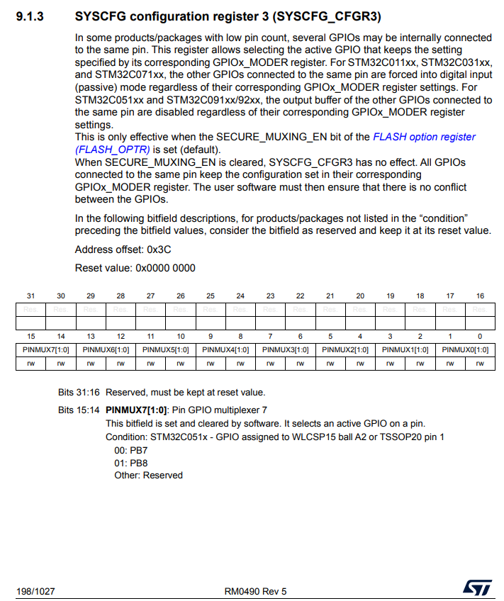

It seems there is a multiplexer ("PINMUX") to decide which GPIO is routed to the physical pin:
https://www.st.com/resource/en/reference_manual/rm0490-stm32c0-series-advanced-armbased-32bit-mcus-stmicroelectronics.pdf#page=198
via: https://www.st.com/en/microcontrollers-microprocessors/stm32c011d6.html#documentation
Dear Duo,
STM32C011xx(SO8 Package) needs remap to use I2C peripheral;
Here is a piece of my example code.
#if defined(USE_STM32C011X_DK)
	/* Remap I/O for STM32C011xx */
	/* Enable SYSCFG */
	__HAL_RCC_SYSCFG_CLK_ENABLE();
	/* Remap PA11,PA12,PC14(1-wire) I/O for SO8 Device */
	if((DEVID_REG == 0x443UL) && (PKG_REG == 0x0001UL)){
		SYSCFG->CFGR3 |= SYSCFG_CFGR3_PINMUX0_0 | \
						 SYSCFG_CFGR3_PINMUX2_0 | \
						 SYSCFG_CFGR3_PINMUX4_0;
	/* Remap I2C1 I/O PA12->PA10,PA11->PA9 */
	HAL_SYSCFG_EnableRemap(SYSCFG_REMAP_PA12 | SYSCFG_REMAP_PA11);
#endif
Entire GCC project is below URL(notice: NO-CUBEIDE/NO-CUBEMX, makefile build only).
https://nemuisan.blog.bai.ne.jp/?eid=192848#STM32C0
