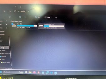

Hello @FBL ,
i have implemented application you have refer on how to interface to PC host through USB MSC . i have implemented EMMC driver mounted on STM32H750B-DK in usbd_storage_if.c  but PC is not detecting eMMC as storage media. i have shared usbd_storage_if.c . i hope you can check and share the implementation is correct or not. also do i have to change jumper to USBFS (CN13) in order to access?
Thank you.

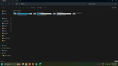

Hello @FBL ,
i have updated code from that repository but still it's not detecting.
I have attached the updated project file. Could you please examine the project and provide your insights on potential misconfigurations or missing steps that might be preventing eMMC detection? Any specific recommendations or adjustments to the code would be greatly appreciated.

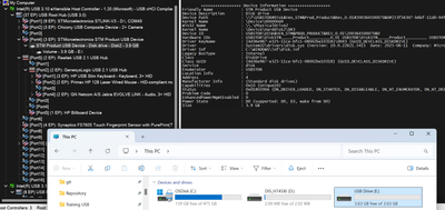

yes i have tried that too just now .. but still same issue.. if it either configuration issue or coding issue?
UPDATE:
the PC detects eMMC sometimes and sometimes it doesn't when i plug it into PC. Also i am not able to format this disk too. it gets disconnected after sometime.
