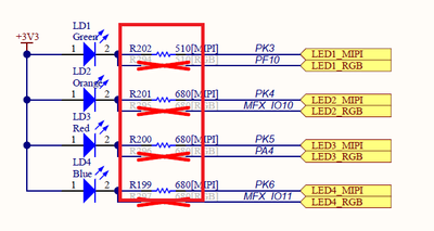

I am not getting the desired output. out of 4 only 3 led is on and it is not blinking. I wanted to know if there is any mistake in the configuration and setup.

Hi @priya_12,
Can you please tell me which pin is not blinking?
And make sure that R202, R201, R200, and R199 for pins PK3, PK4, PK5, and PK6 are implemented and not removed.

LD3 is not turning on, LD1,LD2,LD4 are on but not blinking.
How do I check if resistors are implemented? It is internally connected already right?

Hello @priya_12 ,
First, please kindly use </> button to paste a code. See this post. I've edited your post.
Second, to be efficient please attach your complete project including the ioc file.
What @ELABI.1 said is to check these resistors as it could someone else unsolder them:
But since all LEDs are on except LD3 you need to check the availability of R200.
At different conditions, 3 out of 4 LEDs are on. Either LD3/LD2 is off. So, I don't think there is any issue with the resistors.
