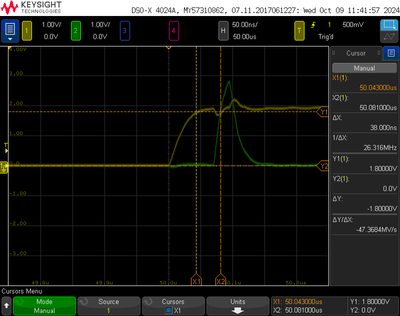

Is the minimum response time of a OPM trigger defined anywhere? I'm measuring a delay of 50-100ns. I was hoping it would be at maximum a couple clock cycles, but I may be naive.
Running on CM4 at 200MHz of the STM32H757i-eval, using Timer8, Trigger source TI1FP1, output on CH2.
In this example code I'm feeding a PWM channel from TIM1 to TIM8 TI1FP1 with a jumper.
I need to generate a short pulse (~25ns) from the rising edge of an external signal, but it seems like the hardware is not responsive enough to satisfy my requirements. ARR = 5, CCR = 0.

‎2024-10-08 1:40 PM
Good catch! That would definitely have affected the first pulse -- but I have it setup as retrigger-able, and am still seeing the same delay in response time for all subsequent pulses.

‎2024-10-09 12:36 PM - edited ‎2024-10-09 12:37 PM
Thank you for the reply. I do have filter off, and I could potentially run the CM4 at 240MHz, hopefully yielding ~20% improvement. The delay is still larger than I would have expected.
We're considering an external pulse generator instead of having the H7 do this. I was hoping the H7 would be up to the task, especially because all the pulse generator ICs I've used in the past seem to be going obsolete, such as: https://pdfserv.maximintegrated.com/en/ds/DS1040.pdf . Might have to consider an FPGA for this signal conditioning?
I updated the pin output speeds and might have improved it to ~40ns delay, but that might be the best I can do. Though putting on the scope, on this STM32H757i-eval board I've got some slow rise time on the TIM1 yellow PWM output and voltage drop when I connect TIM1 PWM output to TIM8 TI1FP1.
‎2024-10-09 1:16 PM
>on the scope
is a DSOX4024A - right ? So you have probes at 10:1 ? and hi-speed probes ? adjusted/calibrated?
because getting about 30ns rise rime is way too slow , for this scope.
Pin output speed H7 at very hi ? (is about 1ns rise time then...so something wrong on your measurement.)
And clock for tim1 is high ? (at 120MHz , APB timer clocks , i think. Makes about 16ns for two FF to set.)

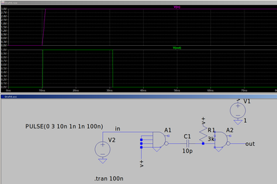

‎2024-10-09 1:55 PM - edited ‎2024-10-09 2:04 PM
>consider an FPGA
Come on - an FPGA for one pulse ?
Just 2 UHC nand gates...
...and you have the 20ns pulse, at about 3ns delay; first gate v+ is control: enable or disable (lo) the pulse.
gates:
https://www.mouser.de/ProductDetail/onsemi-Fairchild/NC7WZ38K8X?qs=jumAldekxNB%252BQGRGFjackg%3D%3D
or mini..
(i like this series...)

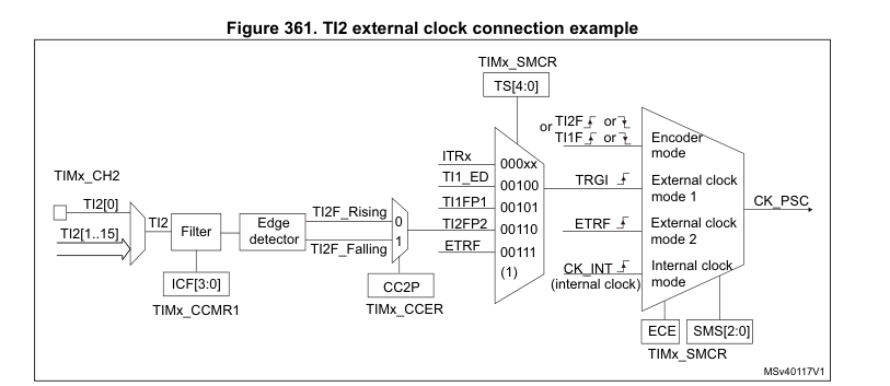

‎2024-10-09 9:28 PM
Tested on my nucleo-H743zi2, get 27 nanoseconds delay. uCPU running at 480 MHz.
Reference manual suggest to set TIM_SLAVEMODE_COMBINED_RESETTRIGGER, but I see no difference with
TIM_SLAVEMODE_TRIGGER.
I also checked bits:
00100: TI1 Edge Detector (TI1F_ED) -> dual edge, same delay
00101: Filtered Timer Input 1 (TI1FP1) <- C6
00111: External Trigger input (ETRF) <- A0

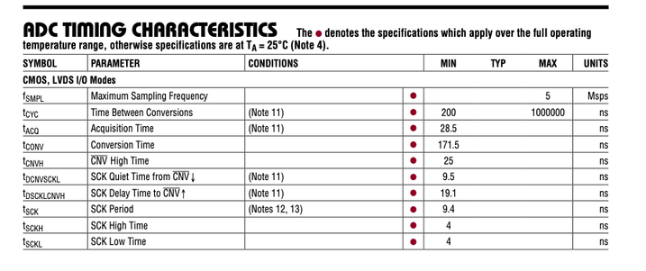

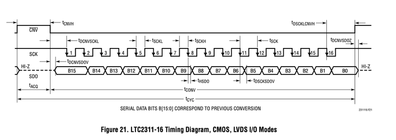

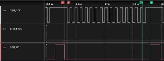

This entire exercise started because once turned on and free running, the STM32 SPI peripheral HW timing at 100MHz does satisfy the requirements of a chip we are using.
The tdcnvsckl at 100MHZ is ~ 6ns and can't be modified in the STM32 SPI peripheral. So the idea was to increase the SPI_CS CNV, MIDI[3:0]: master Inter-Data Idleness time a little, then use that to trigger a smaller pulse. But 26-60ns lag time won't work.
marker 0:0, = 6ns
For electric solution simple CR circuit is solution... delay is zero .
For MCU you require some with analog comparator for example G4 series
