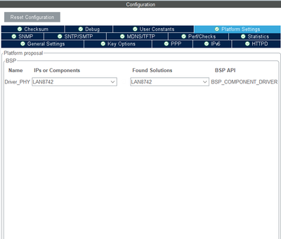

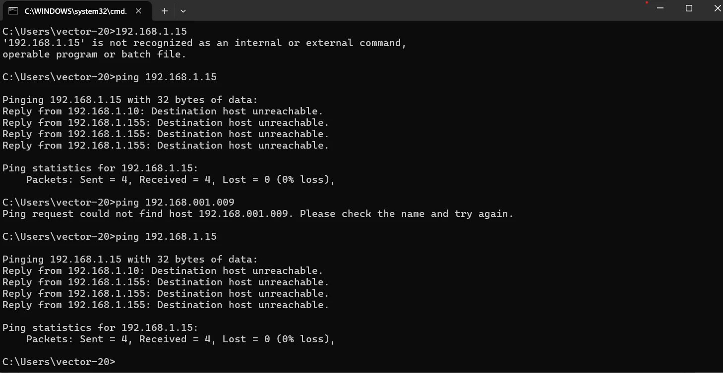

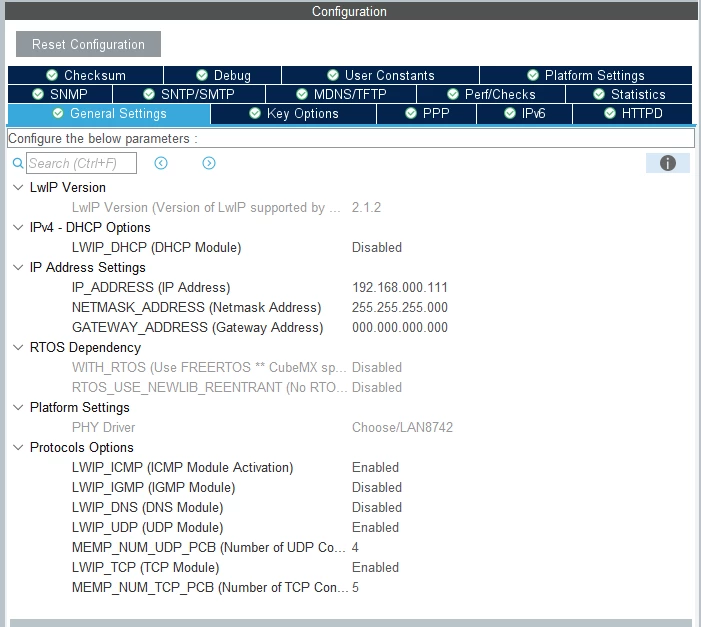

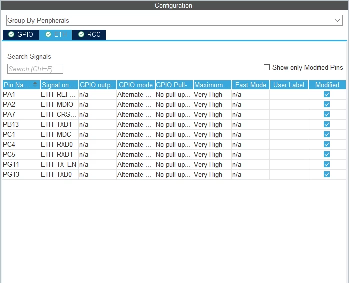

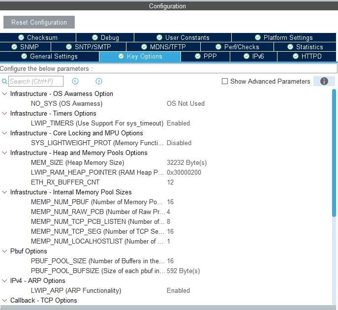

Hello ST Community,
I am currently working with the Nucleo H723ZG board and facing issues establishing a ping response using the LWIP stack. Despite following various examples and configurations, I have been unable to get it to respond to pings. Here are the details of my setup:
  • Development Environment: STM32CubeIDE V1.17  and STM32CubeMX V6.13.0
  • Configuration:
    • I have not used RTOS.
    • I configured the Ethernet settings according to package examples.
    • :C:\....\STM32Cube\Repository\STM32Cube_FW_H7_V1.12.1\Projects\NUCLEO-H723ZG\Applications\LwIP\LwIP_UDP_Echo_Server
    • I ensured that the Ethernet cable was connected properly and used a direct connection to my pc.

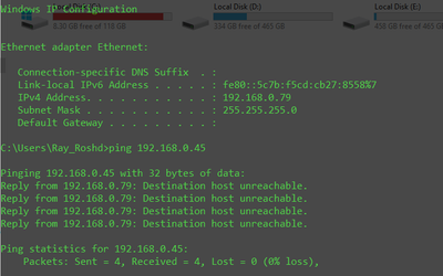

I have tried multiple versions of the H7 package ( 1.12.1 - 1.12.0 - 1.11.1 - 1.11.0 - 1.10.0 ) and tested various configurations without success. The ping command consistently results in "destination host unreachable."Could anyone provide insights or suggestions on what might be missing or misconfigured?

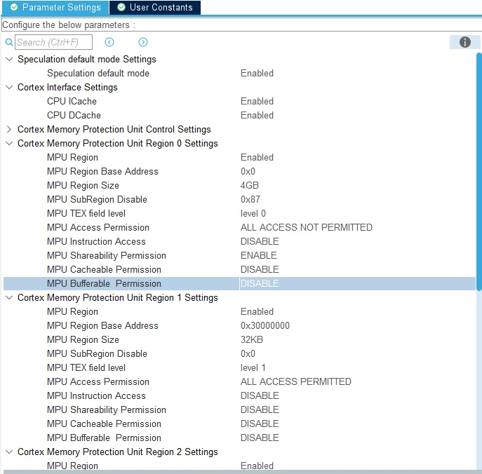

My  Ethernet configuration :

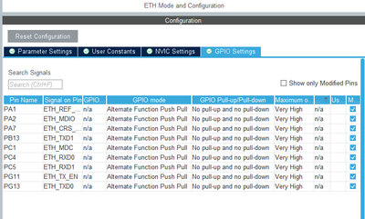

Ethernet GPIO Configuration:

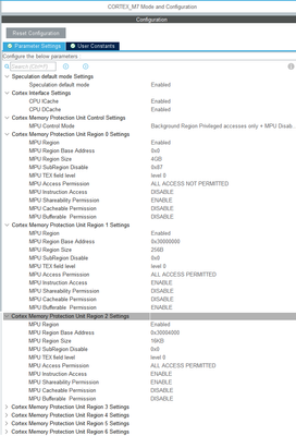

MPU Configuration :

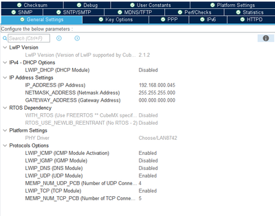

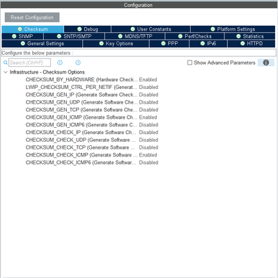

LWIP configuration :

ressult:
My CPU clock is 520Mhz. I am sure the hardware has no problem because I can give a ping from the st package example.
But when I configure according that example it does not work.
.Thank you for your assistance!Best regards,

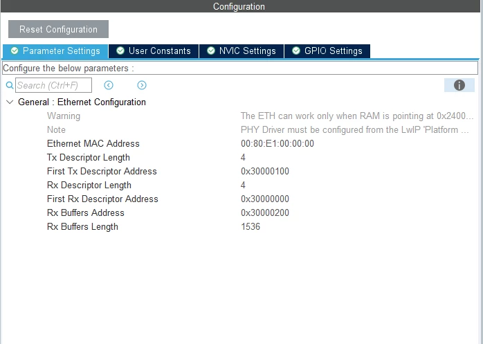

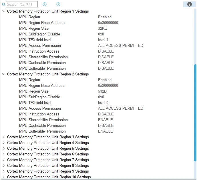

Anyways, reading this post and once again checking the configurations, I was able to create (from scratch) a working configuration. The differences to the original post were:
1) Cortex_M7-> MPU Region 2 -> MPU TEX field level: level 1
2) LWIP->Key Options-> Heap and Mem..->MEM_SIZE=1600
3) LWIP->General Setting -> GATEWAY_ADDRESS: 192.168.000.001
4) Eth->Parameter Settings -> Rx Buffers Address: 0x30000200
5) STM32H723ZGTX_FLASH.ld:
 . = ABSOLUTE(0x30000200);
*(.Rx_PoolSection)

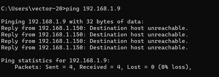

KKonn.1
January 22, 2025
Hello @STea !
 Yes, this was my mistake. I opened the .ioc file to check which address to ping, and there was 192.168.1.9 and tried that. The code was not generated from the .ioc file, since there the address was 192.168.1.15 (and also MPU config missing). Using correct address I was able to ping it.

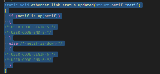

January 22, 2025
Hello @KKonn.1 ,
if you want to check the status of the link you should right your own user code in the dedicated user code begin 5 and user code begin 6 areas in lwip.c  ethernet_link_status_updated function definition:
Regards
KKonn.1
January 23, 2025
Hi @STea !
 That is exactly what I am doing. But the problem is, that ethernet_link_status_updated is not called in bootup at all. I.e. I need to call that function somewhere. I have two options:
Option 1)
Add ethernet_link_status_updated(&gnetif) in the middle of void MX_LWIP_Init(void) like this:
 /* Registers the default network interface */
 netif_set_default(&gnetif);
 ethernet_link_status_updated(&gnetif); //This line added!
 /* We must always bring the network interface up connection or not... */
 netif_set_up(&gnetif);
Then the downside is, that it is overwritten whenever generating code from ioc.
Option 2)
Add ethernet_link_status_updated(&gnetif) in the end of void MX_LWIP_Init(void) like this:
/* USER CODE BEGIN 3 */
/* USER CODE END 3 */
Then the downside is, that no matter what the real status is, netif_is_up(netif) returns always true. Even when the cable is not connected:
static void ethernet_link_status_updated(struct netif *netif)
 if (netif_is_up(netif)) //This is always true after being called from MX_LWIP_Init()
/* USER CODE BEGIN 5 */
	 monitor_task_set_led(LED_ETHERNET, ON); //This is where we end up!
/* USER CODE END 5 */
 else /* netif is down */
/* USER CODE BEGIN 6 */
	 monitor_task_set_led(LED_ETHERNET, OFF);
/* USER CODE END 6 */

MPU setting:
Ethernet Setting:
LWIP :
