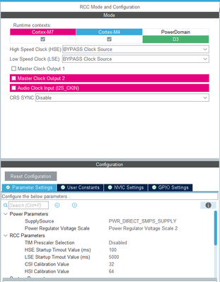

What example you used with UART? the native UART example provided in the CubeH7 or your own example starting from CubeMx?
If yes what power supply you set for this board? SMPS or LDO? you need to set it to SMPS.

I have started a new project with the option "Start My project from ST Board". I can see that in System Core -> RCC the following information
I can see in the main.c that this information is the same:

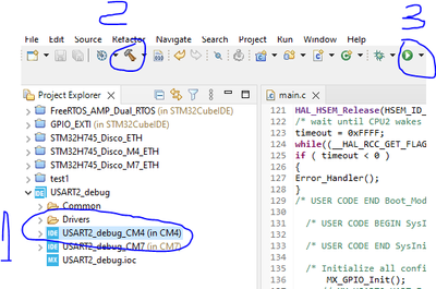

RafaelSAuthor
January 9, 2025
Hello @mƎALLEm
I have commented the lines that you have told me in CM7 and I have commented the following lines in CM4
 MX_GPIO_Init();
 MX_ETH_Init();
 MX_FDCAN1_Init();
 MX_FDCAN2_Init();
 MX_FMC_Init();
 MX_LTDC_Init();
 MX_QUADSPI_Init();
 MX_SAI2_Init();
 MX_SDMMC1_MMC_Init();
 MX_USART3_UART_Init();
 MX_USB_OTG_FS_PCD_Init();
When I run the aplication in stand alone mode, the LED doesn´t blink.
When I run the aplication in debug mode the LED turns ON when the MCU enters in the line
HAL_GPIO_TogglePin(LD1_GPIO_Port, LD1_Pin);
and turn off when the MCU jumps to the next line
HAL_Delay(1000);
And then it is no posible continuing the debug. The code stops in the following line of stm32h7xx_hal.c
while ((HAL_GetTick() - tickstart) < wait)
I imagine this is normal because the timer that counts the ticks might not stop in debug mode.
On the other hand, you mentioned that the CM4 is in low power mode. Do you mean that while debugging the CM7, the CM4 core is in low power mode? If I debug the CM4, for example, will the CM7 be in low power mode?
