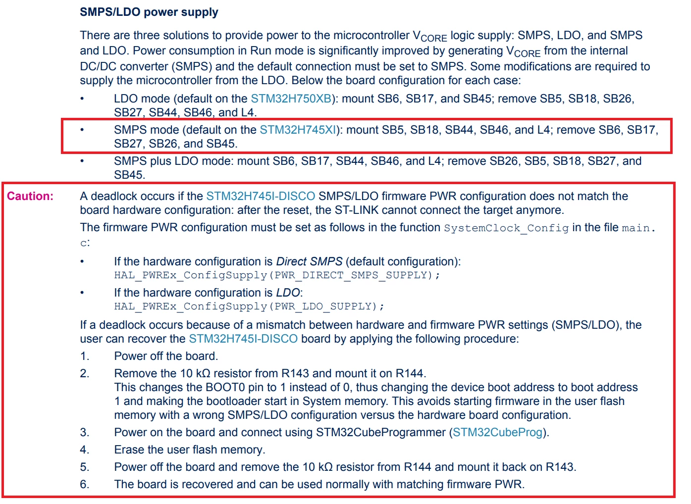

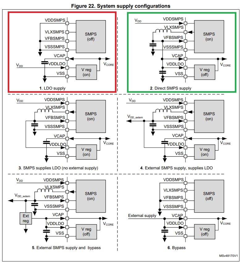

This is why users need to read the documentation before starting a development especially for complex products such as H7 dual core line:
In red is what you configured and in green is what you need to configure for this board. You can notice that the external HW is not the same. So the software needs to follow the hardware configuration:
And also to refer to the Hardware getting started and board's schematics and User manual of it.
This is what is provided in the user manual of the board:
And also at least to refer to the Cube examples and how they were implemented especially for ST boards.

This board is configured in SMPS by hardware, so you can't configure another power supply unless you do a modification on the board.
 /*!< Supply configuration update enable */
 HAL_PWREx_ConfigSupply(PWR_DIRECT_SMPS_SUPPLY);

If you feel the MCU is broken you can recover the MCU. Please refer to this article: https://community.st.com/t5/stm32-mcus/how-can-i-recover-my-stm32h7-board-after-facing-a-power/ta-p/49579

I double checked your system clock config and found this power contig:
 HAL_PWREx_ConfigSupply(PWR_LDO_SUPPLY);
And this is what I have a doubt about!
Need to set it to SMPS:
But this needs to be set after to recover the MCU: https://community.st.com/t5/stm32-mcus/how-can-i-recover-my-stm32h7-board-after-facing-a-power/ta-p/49579
