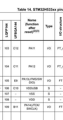

You see in ds what pins are after reset: here from H533
Depending on boot0 pin/signal after reset core starts bootloader or user program.
And after power up the debug unit waits for a "key" sequence, to start swd or jtag actions - or stays sleeping/waiting . So you can still connect "under hardware reset" to the debug unit , even if user program would use the swd pins for other functions and so debug impossible , as soon as user program has control and gpio init is done.

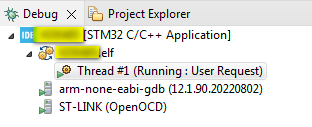

If you have Cube IDE running, the debugger (in ST SWD mode or in the Segger OpenOCD mode) will be interacting with the target, clocking stuff into the long SWD shift register chain and clocking out the CPU registers, etc. Cube shows this
So the SPI1* (remapped to PB3-PB5) will obviously not work.

3) Once the AF is changed to SPI (whether the above mux is used or not) the debugger interface will fail and Cube will automatically drop out from debug mode. It never restarts debug mode (you have to do another build-debug with F11) and quite often this occurs anyway by itself.
