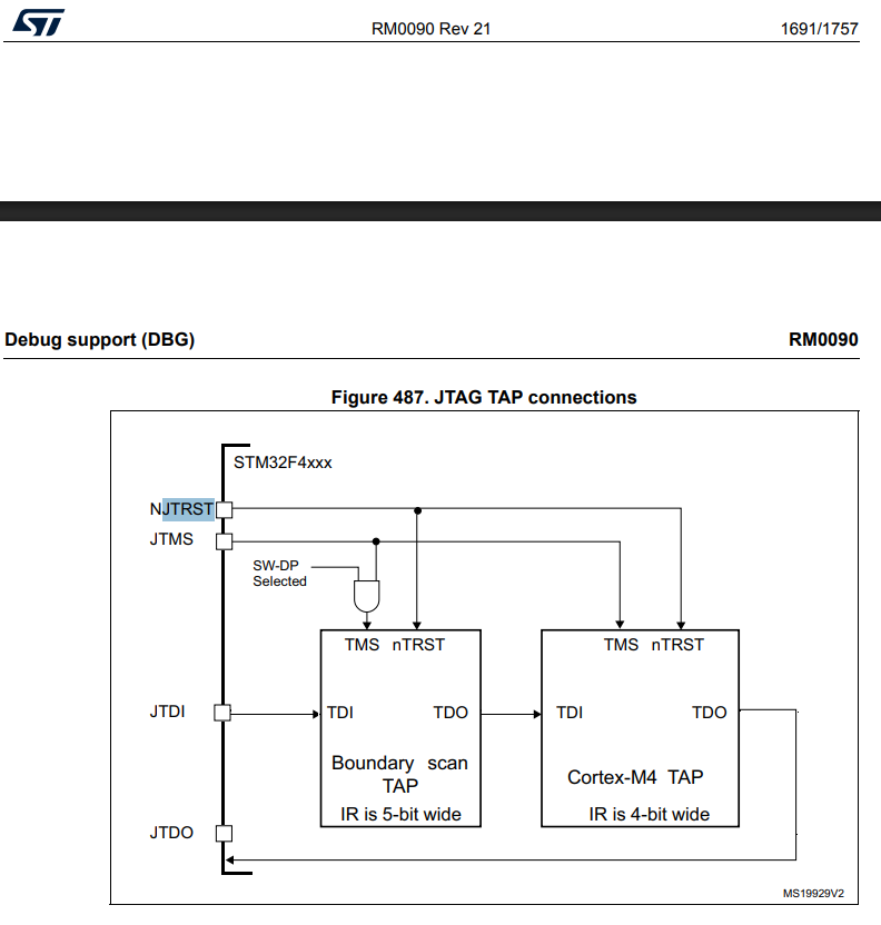

@PHolt.1 wrote:
But what does NJTRST actually do? It came up here
The thread says it just resets the debug controller.
It's only relevant if you're using actual JTAG - not SWD.
@PHolt.1 wrote:
suggested delay before reconfig of the SWD pins.
Yes - I also suggest that in the link I posted earlier.

OK so one needs to be sure that putting muck on NJTRST does not break anything.
EDIT: just seen your PS. Can we be sure waggling NJTRST will not break anything, either during FLASH programming or during code execution?
Stuff appearing on NJTRST could well violate reset timing specs on the TAP controller.

This topic comes down to whether "muck" injected into NJTRST will definitely not break something on the CPU.
If the SPI (mapped to the SWD pins, as per this thread) is used for output only then this issue does not arise.
waclawek.jan
December 13, 2025
NJTRST is JTAG pin, not SWD, so if you don't use JTAG for debugging - and there are only marginal reasons to do so, so it's very unlikely you do - there is no "muck" injected into it, the JTAG state machine is disabled as soon the debugger enables SWD, they are mutually exclusive.

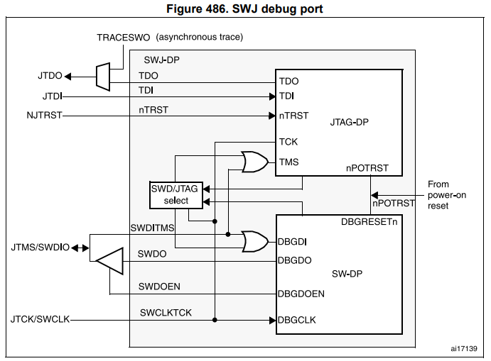

What if the chip is powered up without a debugger. Is SWD the power-up default i.e. the JTAG portion does nothing at all unless some "code" is sent on the debug pins to configure it?
AScha.3
December 14, 2025
You see in ds what pins are after reset: here from H533
Depending on boot0 pin/signal after reset core starts bootloader or user program.
And after power up the debug unit waits for a "key" sequence, to start swd or jtag actions - or stays sleeping/waiting . So you can still connect "under hardware reset" to the debug unit , even if user program would use the swd pins for other functions and so debug impossible , as soon as user program has control and gpio init is done.
waclawek.jan
December 14, 2025
The power-on default is JTAG, and it does nothing unless - as you say - some "code" is sent to it. This involves wiggling TMS and TCK, as long as these pins are static (rigorously speaking, if TMS is high), nothing happens externally. TMS is pulled up after reset (see GPIO chapter in RM), so if that pin is unconnected, everything is safe. TMS and TCK are also - and not coincidentally - the SWD pins, and to switch on SWD (and disable JTAG), another "magic code" has to be "played" at those two pins; that "magic code" is deliberately designed so that no part of it can generate a valid JTAG instruction, so you can hot-plug the SWD connector while the debugger is playing continuously the "magic code" and it won't switch to JTAG.
TLDR is, that as long as you use the SWD pins only for debugging, you are safe. So yes, some thought went into these things, which are btw. designed by ARM, not by ST.
Just a side note, nTRST is an optional JTAG signal which does nothing with the DUT (i.e. the mcu itself), it just resets the internal JTAG state machine.

As I've explained above, PB4 set to NJTRST has nothing to do with SWD, it's a JTAG signal and JTAG is inactive once the debug interface is in SWD mode.
PB5 has nothing in common with debug at all.
PB3 in SWD mode *can* be set as TRACESWO, so simply don't set it as such - not in program nor in IDE - and you're fine.
As a second thing which makes sure SPI works is, that if PB3 and PB4 are set as AF in GPIO_MODER and to 5 (which is for SPI1) in GPIO_AFR[], the debug functions are disconnected and SPI is connected to these pins.

Turns out that page 873 of the 32F417 RM has this note
My interpretation of it is that this is fine provided your code does not re-initialise these pins until the debugger has finished with them.
When they say "disable both JTAG/SWD interfaces" they surely mean when the debugger has finished, because user code has no means of controlling JTAG/SWD.
