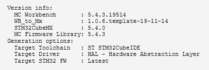

I am develloping a system using the motor control sdk. I am usiung the ‎STSPIN32F0‎ chip and the following software versions:

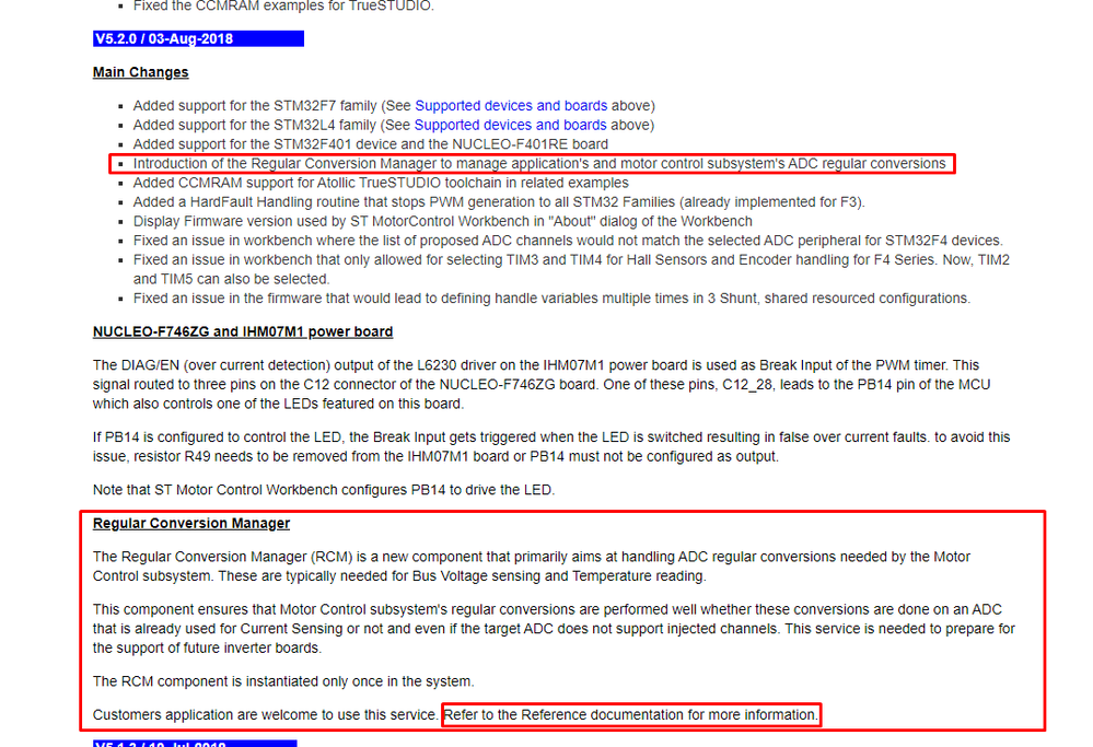

This module only has one ADC peripheral and I need to use it in my application. Looking around, I have found that the Regular Conversion Manager (RCM) might be exactly what I need for this situation. I can see in the release notes that this feature was added in the 5.2.0 version:

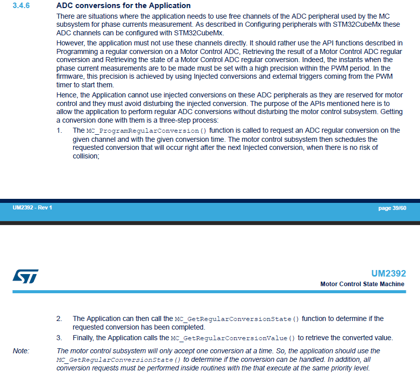

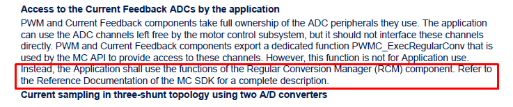

They say to "Refer to the Reference documentation for more information.". So I looked at the documentation for my version which I found in the motor control worbench under "Documentation->STM32 motor control SDK5.x - Firmware". In this document, I found the following information:
and also:

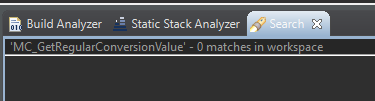

This is all good and well, but when I search for these functions in my STM32cubeIDE workspace were I have the project it doesn't find anything:
I have also manually looked in mc_tasks and mc_api where these functions should be located.
