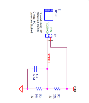

What is the principle/working mechanism of the Driver Protection in the STSPIN32G4?

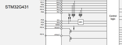

Why can't I find the E15 pin?:)
4 REPLIES 4
AScha.3

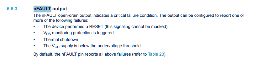

in ds:
is internal:
see here:
from:
Thanks! @AScha.3
So that means nFAULT will be triggered if Vds is greater than 1.03125 V?  : )

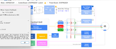

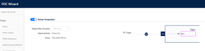

Hi @AScha.3
If I’m using the Workbench from MCSDK_v5.Y.3, how do I enable the Vds protection feature? :)
