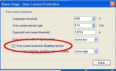

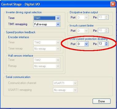

I am unable to change the port and pin for the Over current Protection Disable in Motor control workbench.  All the enables for this are set properly.  I can edit the output files and change the pin but not in the MCWB application.  Is this a bug or am I missing something?
Photo included shows option greyed out.

The over current protection disabling feature is intended to be used together with the on over voltage action ''Turn on low side switches''. So to enable are required the three steps below
1) Enable the Over-current protection disabling network in the power stage

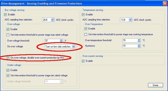

2) Select ''turn on low side switches'' as on over voltage action in the drive management and enable on over-voltage disable over-current protection by HW check box
3) Set the over current protection disabling port and pin
