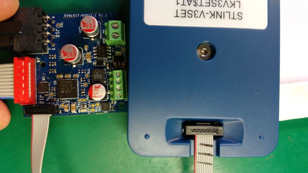

I want to buy EVALKIT-ROBOT-1 but I do not undestend how i can connected to PC, because that board (STSPIN32F0A) have not USB port and have not embedded ST-Link.

The EVALKIT-ROBOT-1 has a dual row 10 pins header with 1.27mm pitch spacing for programming/debugging (J12).
You can use the ST-LINK/V3 that have this connector type.

I have the STLINK-V3SET in use and it´s fairly easy to connect. On the back of the debugger, you´ll find a 10x2 pin header, on the pcb of the STEVAL-ROBOT-1, you´ll find the same header. So just connect the (with the debugger) included flat cable at both ends, plug in a micro usb cable into the debugger and you´re up and running...

Thanks Chaaalyy! Here is a photo of the programming cable hooked up in case it wasn't clear for anyone else. I did measure out those resistors and they all seem 100 ohm to me so should be ok. (the comm connector isn´t connected directly to the f0-mcu.)--geez. I would have thought to go with I2c not modbus but thats later/at the moment I dont even have a usb to rs485 so in the main loop I will probably also fiddle around there. Anyway I only got it today so tomorrow should be fun...I hope
