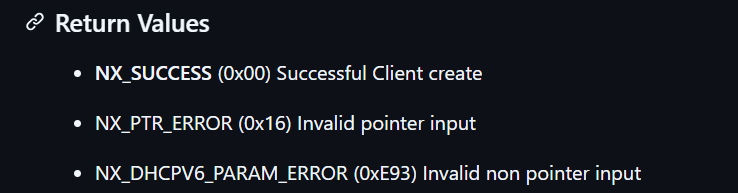

In AZRTOS - NetXDuo ver 6.4, netx-duo-dhcpv6-client library,
if NX_DISABLE_ERROR_CHECKING is not defined (i.e. calling first _nxe_dhcpv6_client_create()),
function nx_dhcpv6_client_create() should check for valid input parameters and return errors according to error type.
From manual:
Create a DHCPv6 client instance
Prototype
UINT  nx_dhcpv6_client_create(
    NX_DHCPV6 *dhcpv6_ptr,
    NX_IP *ip_ptr,
    CHAR *name_ptr,
    NX_PACKET_POOL *packet_pool_ptr,
    VOID *stack_ptr,
    ULONG stack_size,
    VOID (*dhcpv6_state_change_notify)(
        struct NX_DHCPV6_STRUCT *dhcpv6_ptr,
        UINT old_state,
        UINT new_state),
    VOID (*dhcpv6_server_error_handler)(
        UINT op_code, UINT status_code,
        UINT message_type));
Description
This service creates a DHCPv6 client instance including callback functions.
Input Parameters
  • dhcpv6_ptr: Pointer to DHCPv6 control block
  • ip_ptr: Pointer to Client IP instance
  • name_ptr: Pointer to name for DHCPv6 instance
  • packet_pool_ptr: Pointer to Client packet pool
  • stack_ptr: Pointer to Client stack memory
  • stack_size: Size of Client stack memory
  • dhcpv6_state_change_notify: Pointer to callback function invoked when the Client initiates a new DHCPv6 request to the server
  • dhcpv6_server_error_handler: Pointer to callback function invoked when the Client receives an error status from the server
Return Values
  • NX_SUCCESS (0x00) Successful Client create
  • NX_PTR_ERROR (0x16) Invalid pointer input
  • NX_DHCPV6_PARAM_ERROR (0xE93) Invalid non pointer input
Actually if parameter
does not point to a packet pool ( as when the variable has been defined but not initialized ), the functions does not returns NX_DHCPV6_PARAM_ERROR (0xE93) Invalid non pointer input but NX_SUCCESS (0x00) Successful Client create.
As for every discrepancy between reference manual and actual code, could be that manual is inaccurate, but in this case it is mandatory to edit ASAP with correct wording.

Hello @mbarg.1 ,
Just wanted to point out that as per the NetX documentation in GitHub implies:
"In the "Return Values" section in the following API descriptions, values in BOLD are not affected by the NX_DISABLE_ERROR_CHECKING define that is used to disable API error checking, while non-bold values are completely disabled."
and since only NX_SUCCESS is in bold and other return values are not those two are completely disabled.
just wanted to know how you are passing the uninitialized pointer to this function and are you sure NX_DISABLE_ERROR_CHECKING is not activated?
also, I want to point to you that issues related to Nextduo documentation should be input in Issues · eclipse-threadx/netxduo
Regards
I can confirm - because I did this very same mistake of forgetting to initialize packet pool - that IF packet_pool_ptr is not NULL, but data inside are all zero (non initialized pool)  you get NX_SUCCESS (0x00) - NX_DISABLE_ERROR_CHECKING not activated.
Have a look at code below:
packet_pool_ptr is tested only for NULL ptr value in _nxe_dhcpv6_client_create()
and assigned to dhcpv6_ptr -> nx_dhcpv6_pool_ptr in _nx_dhcpv6_client_create().

Hello @mbarg.1 ,
This seems to be valid to me if the pointer is declared and uninitialized this will return success assuming that the pointer was declared with value different than NULL so I suggest that you declare the pointer to a NULL value, and it should then catch the error and as suggested before this should be input  in Issues · eclipse-threadx/netxduo as this is not ST documentation and source code but eclipses open-source code.
Regards
Sorry, but i do not agree.
A function must return NX_SUCCESS when it performs what is intended to do, some ERROR otherwise.
I our case, function is intended to send a packet and if packet cannot be sent, MUST return ERROR, not NX_SUCCESS.
I agree that the problem involves Eclipse ThreadX but STM is partecipating to this project, not me; is up to you to lobby for bug resolution, or edit code / manuals before using in libraries in your IDE.
Discussions with STM officials did agree on that, so far.
Hello @mbarg.1 ,
I'm reporting the issue internally (ticket number 201985 for internal reference only) to AZRTOS experts. When you said, "Discussions with STM officials did agree on that, so far.", do you mean that you are discussing same issue with other colleagues who confirmed it?
Regards
