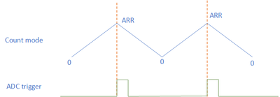

How to synchronize ADC triggering at the peak of the up-down counter ?
ADC1 is triggered using TIM1 trigger out event, and TIM1 has center counter mode as aligned mode3.
Thank you in advance !

Hi Sarra,
Thank you for replying, that is what I have done and I have the trigger event but at the start of the ARR value, I would like to have the trigger at ARR, which would be the midpoint of up down counter as shown in the below image.
I am working with STM32G431.

oh, I see, thank you for the explanation,
Taking into account that you are using center-aligned mode, which alalternates between counting up (0 -> ARR) and counting down (ARR-> 0) to make a period, once the counter reaches the ARR, you trig the ADC. To do that you should interconnect the TRGO signal of your timer to the ADCx that you want to use for conversion using EXTSEL in the ADC_CFGR register.

I have settings as below:
with the settings of ADC trigger as below, I have connected TIM1 to ADC1 using TRGO2.
hadc1.Init.ExternalTrigConv = ADC_EXTERNALTRIG_T1_TRGO2;
But now the question is how do i set the TIM1 in a way that can give me trigger as explained in above post. I have 3 channels of TIM1 generating 3 PWMs. Channel 4, 5 and 6 are not being used.
