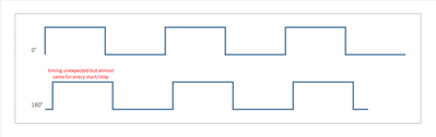

mxoAuthor
September 15, 2023
represent the problem by diagram. see attached 'diagram1.png'.
>>now I'm trying some TIM initialization made before restart, but still not work as expected.
following is one of my trial.
I wonder that the answer is close here but not found now..
 -call "generate event" before PWM start
 --> result
regards.
waclawek.jan
September 15, 2023
I don't know what are you trying to do, but generally, if the slave has slave-mode controller set in Trigger mode, it does nothing more than set TIMx_CR1.CEN when first trigger arrives. In other words, if you set TIMx_CR1.CEN) in software, there's no effect from the trigger.

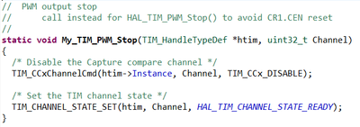

mxoAuthorBest answer
September 19, 2023
hello @waclawek.jan
thank you for your advise, and now it was solved.
I used HAL_TIM_PWM_Stop() before, but it reset CR1.CEN I found.
then I modify it not to reset CR1.CEN as followings, and works as well expected.
regards.
