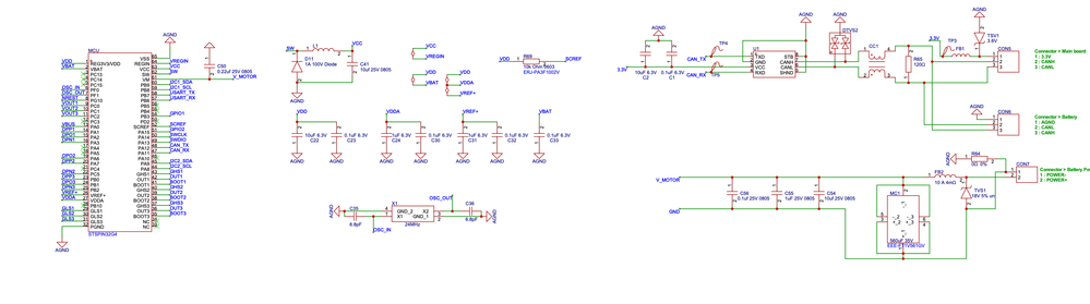

Dear @GMA
We have change the design following the EVSPIN32G4 design but still facing the same issues

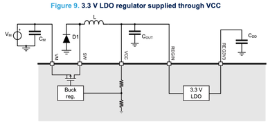

We’re using the default 3.3V LDO solution for the STSPIN32G4 core.
However, for peripheral devices like sensors, a CAN bus transceiver, and a temperature sensor, we chose to use an external 3.3V supply.

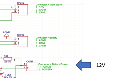

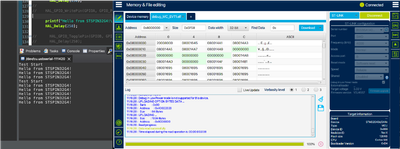

Case 1: 12V to MV only
- STSPIN32G4 can be connected
- Firmware can be flashed
- UART output works normally

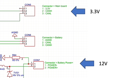

Case 2 : Provide 3.3V & 12V
- STSPIN32G4 can still be connected
- (X) No UART output
- (X) All GPIOs appear inactive

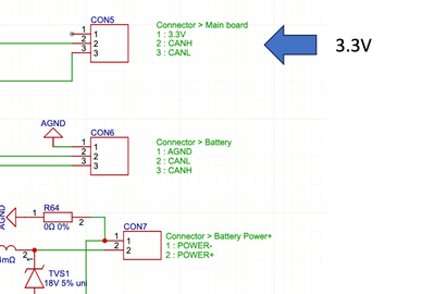

Case 3: External 3.3V only (to test chip conduction)
Only the following Pins has voltage
PA8 - I2C2_SCL : 3.3V
PA9 - I2C2_SDA : 3.3V
PA11 - CAN_RX : 3.3V
PA12 - CAN_TX : 3.3V
PB6 - I2C1_SCL : 3.3V
PB7 - I2C1_SDA : 3.3V
This makes sense, as these are powered by the external 3.3V for peripherals.
However, we are unsure why the chip malfunctions or stops responding when the external 3.3V is connected alongside 12V.

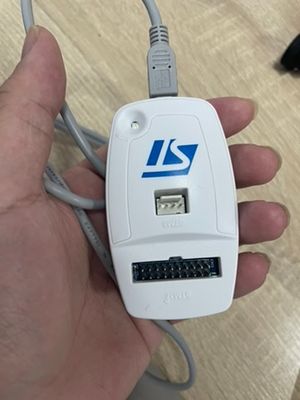

Dear  @Andrew Neil
Thanks for your response.
We also realized this and change to the official STM version, the obersvation you could look at our second reply
The issue we’re facing is that when we introduce external 3.3V into the system (to power peripheral sensors), the STSPIN32G4 stops working.
Here’s what we observed:
  • We first flashed a test image that toggles the GPIO pins high/low at 1Hz.
  • With only 12V input and no ST-Link connected, the G4 runs fine and toggles the GPIOs as expected.
However, once we connect the external 3.3V (to power sensors, CAN transceiver, etc.), the G4 crashes, and all GPIOs stop functioning.
We’d appreciate any insight into why this might be happening, or what kind of conflict could exist between the internal 3.3V LDO and the external 3.3V supply. We have ensured that all GNDs are properly connected, and the external 3.3V supply is clean and stable — confirmed through oscilloscope analysis, with no noticeable noise or ripple.
here is the ST-Link we are using, Since G4 don't have 3.3V output so we support external 3.3V to the device as well
