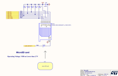

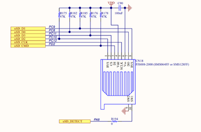

The STM32L476G-EVAL board have a slot for microSD™ card supporting SD, SDHC, SDXC.
I recommend you referring to the board schematic and get inspired to design your PCB.

Hello @KDJEM.1 ,
Thanks for your answer. Unfortunately, the design you reference is of no help with my problem. The µController (STM32L476G) used on this design does not have a SDMMC1_CKIN pin. So I can't deduce anything concerning the usage of the STM32L476ZGT6U signal.
