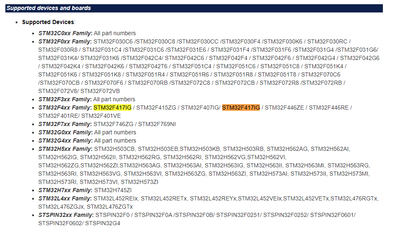

I am working on a three phase motor inverter with a logic board powerd by the STM32F429VITx MCU and my goal is to run code generated with the ST Motor Control WorkBench on that board.
When I create a new custom inverter in the WorkBench Board Manager and set the Parameter
"mcu": "STM32F429VITx"
my new inverter does not appear among the options in the WorkBench, so I assume it's not supported yet by the WorkBench to generate a project for STM32F429VITx.
Here I found, that all STM32F4xx MCU's are supported by ST MC SDK, but apparently ST MC Workbench only supports generating projects for a subset of them.
In the Release Notes for X-Cube-MCSDK 6.2.0, these are the supported MCU's:
Is the list in the release notes for X-Cube-MCSDK 6.2.0 the complete list? Why is e.g. STM32F417IG listed twice?

Thank you for your post!
We will add a comment on wiki page about the WorkBench supported MCU list limitation.
Unfortunately, only MCU listed on the release notes for X-Cube-MCSDK/ are supported and adding the corresponding json file will not be sufficient, we would like to sincerely apologize for this miss-understanding.

Hi @Nate-S,
Thank you for your question.
For some MCU families, indeed the ST MC Workbench supports only a subset parts number. This is the case for STM32F4.
Increasing the number of supported MCUs is an ongoing task with a big step forward in the MCSDK 6.2.0 and 6.2.1. To answer your question, we support the STM32F4 listed in the release note because they are parts of ST boards.
To go forward, I would advise you to stay with a supported MCU in your boar description. In your case a STM32F446 as it has 3 ADCs as the STM32F429. Generate your motor control IOC with this config, and once done you can import it into an empty STM32F429 IOC thanks to the import feature of CubeMX once done you can re-generate your motor control project from cubeMX. From our experience, it works pretty well, even if sometime clock settings have to be doubled checked.
The support of the whole STM32F4 family is in our plan for middle of next year.
