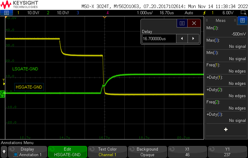

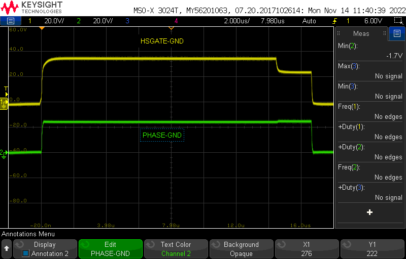

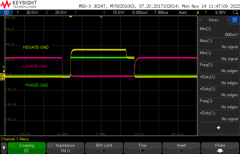

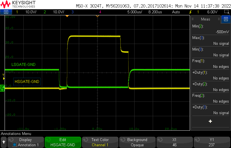

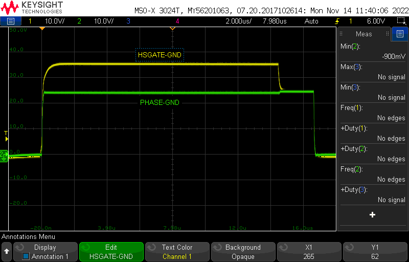

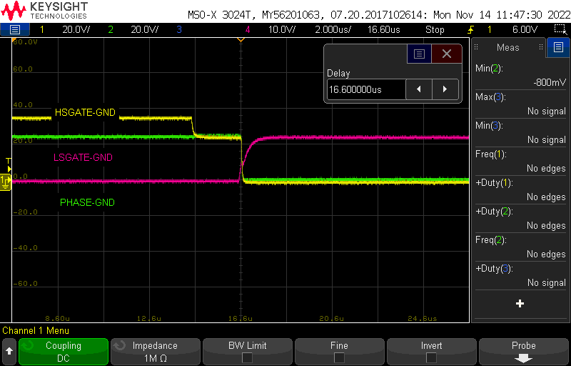

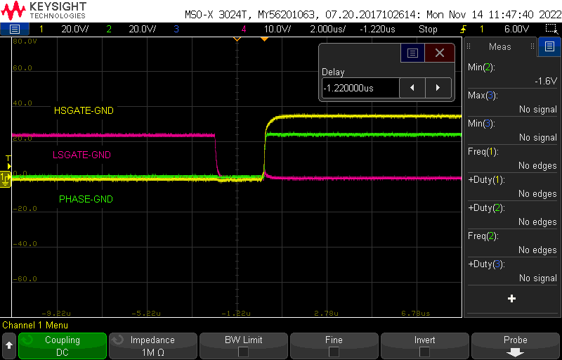

I have a steval-spin3201. It includes stm32f031 mcu. I am programming it by using stm32cubeide. When I was testing PWM and dead time, I noticed that the one of phase output is not synchronous with mosfet gate signal.
I shared the scopes below. Can you help me to understand?

Your waveforms show expected device behavior.
During the dead time the phase output is in high impedance and its voltage it is not driven at any level.
