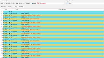

Hello @GMA ,
Thank you for the instructions. I have updated the .ini file as requested. Here are the logs from the MC Pilot Terminal tab during the connection step:

Hello @JulesC,
MC Pilot sends a beacon message. Clicking on the ASPEP_BEACON message, MC Pilot displays the decoded message. The message is correctly decoded on the microcontroller unit (MCU) side. On the universal asynchronous receiver transmitter (UART) side, a BEACON response (0x05C70114) is sent, but MC Pilot does not receive it.
Check the USB cable and the STLINK-V3MINI. Try using another PC.
If you agree with the answer, please accept it by clicking on 'Accept as solution'.
Best regards.
GMA
JulesC
Hello ,
Thank you for your answer.
Actually my colleague and I found that the JP15 link (which should be closed by default) was open. Once we added a wire, we were able to connect to Motor Pilot successfully."
