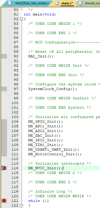

image 01 - Breakpoint at line 114 of main.c where MX_NVIC_Init() is called. I reset the board and example code reaches this point as expected (see yellow cursor)

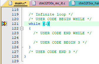

image 02 - Breakpoint at line 121 of main.c where while (1) is called. I advance example code from line 114 (press F5), and the code runs forever but never reaches while (1).

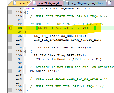

image 03 - I stop code and follow function calls up to the highest level, I find an interrupt request handler TIMx_BRK_M1_IRQHandler(). I set a breakpoint inside this function and run example code over and over (press F5, F5, F5) and I see this interrupt request handler is called forever. Maybe this is why example code never reaches while (1)?

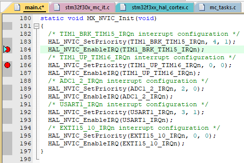

image 04 - Breakpoints at lines 184 and 186 inside MX_NVIC_Init(), I reset the board and tap F5 and see the code gets to line 184 but never reaches 186. It is stuck in IRQ, as seen previously.

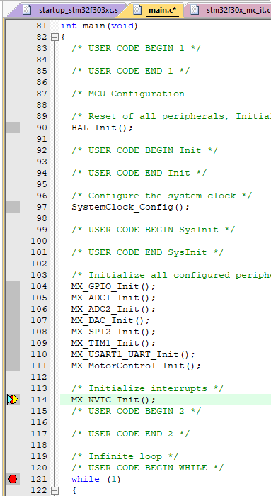

image 05 - But if I start at line 184 and advance line-by-line (hold F11) the code will advance as expected! The code will advance through the entire MX_NVIC_Init() function and will even reach my while (1) loop as expected. But only if I manually step through the code one line at a time with the debugger. During normal operation without breakpoints the code does not work.
Please can you advise?
