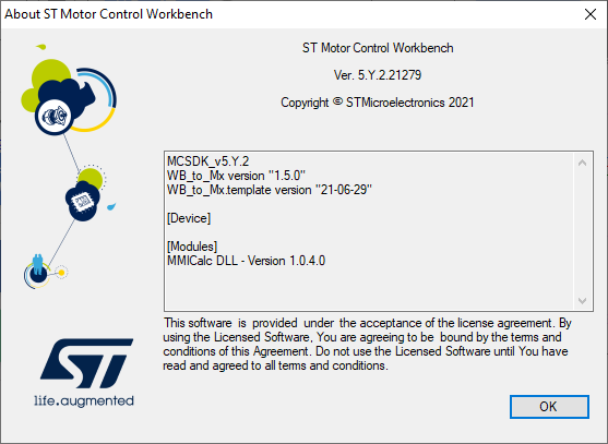

thank you very much for your quick reply.
Keeping your hints in mind I:
1.) installed MCSDK version 5.Y.2
2.) opened the 6S_IHM16_HS_VM.stmcx file with ST Motor Control Workbench and saved it to an empty location
3.) pressed the UPDATE button in the "Project generation" window while the Driver type "LL-Low Level" was selected
   -> in the ST32CubeIDE folder only the .project file was created (usually there should be a .cproject file as well)
4.) STM32CubeIDE: Right click into "Project Explorer"->"Import ..."->"Existing project into workspace" to import the project results into importing an empty project I cannot compile.
So only when I use the GENERATE button in the "Project generation" window I actually get an configured project I can meaningfully import (via the .cproject file).

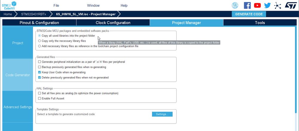

As far as I understand your trouble, I can see two ways getting the example source files from our MC SDK.
1st one is to generate the example for another IDE, like EWARM.
2nd one is to update the example like you do for steps 1) to 3), then to open the 6S_IHM16_HL_VM.ioc file with STM32CubeMx, then going to the Code Generator sheet (within Project Manager tab) to select the "Copy all used libraries into the project folder" as shown below and to click on generate button inside STM32CubeMx. Finally, you can compile using CubeIDE and download the elf file
