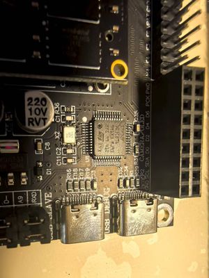

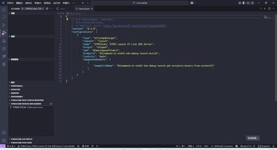

编译正常,也能识别到stlink,但是没办法运行调试烧录,也没办法升级stlink固件 ,一烧录就显示以下报错,目前没找到解决办法,但网上已有与我相同问题的用户

Peter BENSCH
Welcome @jiangkoumo, to the (English speaking) community!
What type of ST-LINK are you using?
Could you please include a photo of it, and if it is in a plastic case, please include a photo of the back as well?
Regards
/Peter

是自己设计的板子上板载的stlink,用的f103cbt6芯片做的,使用的stlink-v2的固件
升级会提示失败,下面图片是报错信息

调试控制台的输出信息如下:
STMicroelectronics ST-LINK GDB server. Version 7.10.0
Copyright (c) 2025, STMicroelectronics. All rights reserved.
Starting server with the following options:
Persistent Mode : Disabled
Logging Level : 8
Listen Port Number : 61234
Status Refresh Delay : 15s
Verbose Mode : Disabled
SWD Debug : Enabled
InitWhile : Enabled
Device connect error
Error in initializing ST-LINK device.
Reason: Failed to connect to device. Please check power and cabling to target.
cube has exited with code 1GNU gdb (GNU Tools for STM32 13.3.rel1.20250523-0900) 14.2.90.20240526-git
Copyright (C) 2023 Free Software Foundation, Inc.
License GPLv3+: GNU GPL version 3 or later <http://gnu.org/licenses/gpl.html>
This is free software: you are free to change and redistribute it.
There is NO WARRANTY, to the extent permitted by law.
Type "show copying" and "show warranty" for details.
This GDB was configured as "--host=x86_64-w64-mingw32 --target=arm-none-eabi".
Type "show configuration" for configuration details.
For bug reporting instructions, please see:
<https://www.gnu.org/software/gdb/bugs/>.
Find the GDB manual and other documentation resources online at:
<http://www.gnu.org/software/gdb/documentation/>.
For help, type "help".
Type "apropos word" to search for commands related to "word".
add-symbol-file "C:/Users/jiangkoumo/Desktop/1_led_twinkle/build/Debug/STM32H7xx.elf"
add symbol table from file "C:/Users/jiangkoumo/Desktop/1_led_twinkle/build/Debug/STM32H7xx.elf"
(y or n) [answered Y; input not from terminal]
Reading symbols from C:/Users/jiangkoumo/Desktop/1_led_twinkle/build/Debug/STM32H7xx.elf...
Nawres GHARBI
seems your board is not connected or well powered please check from this side
If it is already the case sometime the ST-link FW needs a power cycle to work so I invite you to unplug and re-plug your board
