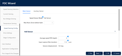

Hello @Christophe65,
For Hall sensor use case oscillations, could you run a test with the following Hall sensor speed sensing configuration?
If you agree with the answer, please accept it by clicking on 'Accept as solution'.
Best regards.
