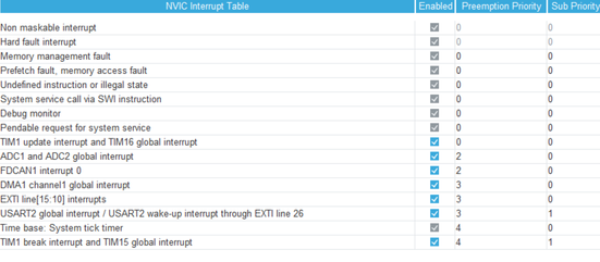

I am assuming it is a priority issue, which is set as

Update : HAL_UART_Transmit_IT() works
I'm guessing there's some conflict btw DMA and MotorControl

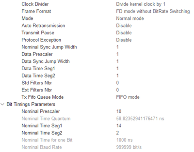

Update : FDCAN also works, so anyone who tries to use FDCAN,
my setting is (for 170MHz clock)
I don't know what's wrong with DMA really.
‎2023-07-06 4:29 AM - edited ‎2023-07-06 4:30 AM
Regarding your FDCAN bitrate config, I see 999999bit/s. So please try to find another values for NSEG1 and NSEG2 to have exactly 1000000bit/s (1Mb/s)
‎2023-07-06 5:17 AM
I cannot imagine that 1ppm deviation of the FDCAN bitrate is the problem here...
