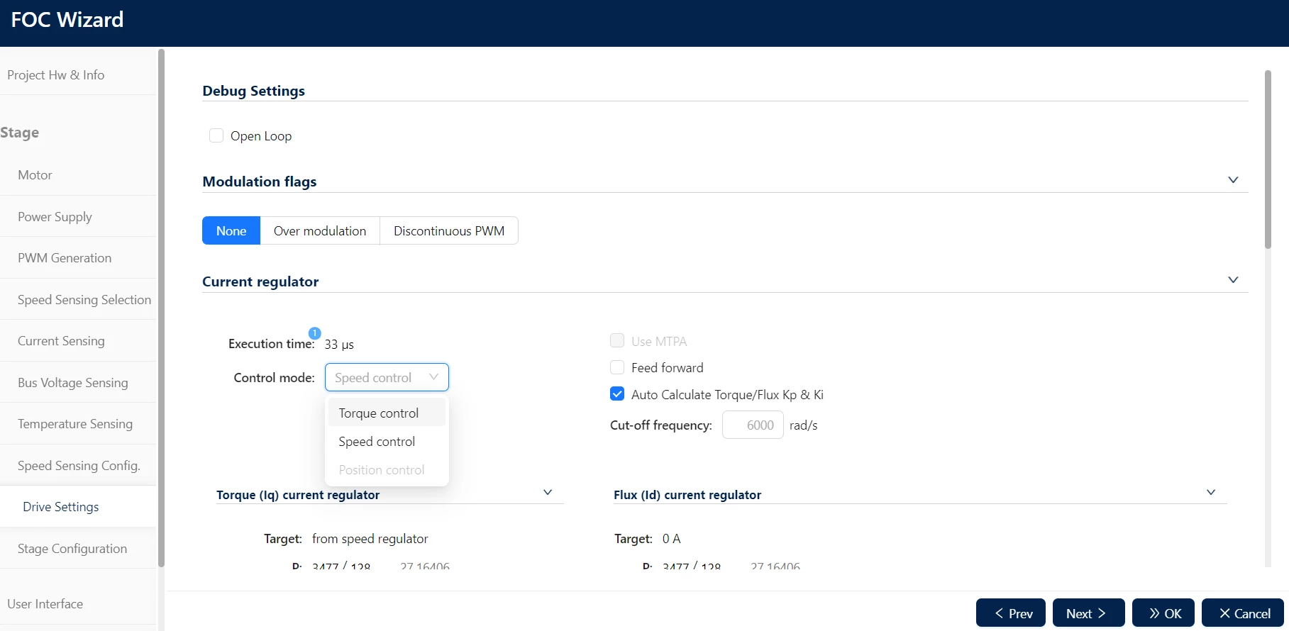

Hi, I'm newbie to Motor Control workbench(6.3.2) . I have STM32 G431RB and IHM08M1.I want to control the position of BLDC (42BLFX01E). This motor has 3 Hall Sensors.  I successfully run the motor using motor profiler and implemented the speed control. Now for position control when i selected my IHM08M1, STM32 and relevent motor in FOC Wizard. I can only select Torque and Speed Control. Is there any way to implement position control without encoder ? Thank youScreenshot 2024-11-25 121016.png

Hello @SannanAli and welcome to ST community,
As mentioned in user manual documentation available through "Workbench tool">About>Documentations>Documentation>"User manual", "Position Control" link, Position Control feature is only available with Quadrature encoder with or without index signal.
If you agree with the answer, please accept it by clicking on 'Accept as solution'.
Best regards.
