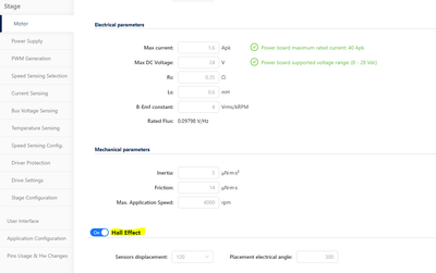

I'm trying to set up a custom board based on the B-G431-ESC1, with the MC Workbench and the SDK Version 6.2.1.

However, inside the MC Workbench I can only choose between the two observer option.
None of the hall options show up, neither as the main nor the auxiliary sensor (in this context they're greyed out and cannot be chosen).
There is no message as to why this is the case either.

Hello @DMeie.2,
Are the hall sensors configured in the motor section ?

DMeie.2
Senior II
Thanks, that worked!
So it depends on the motor configuration as well. Makes sense.
