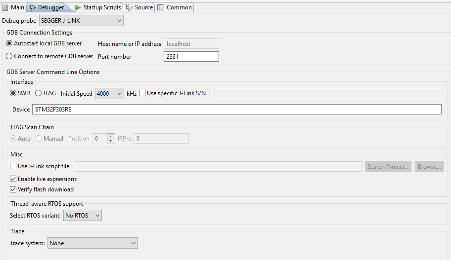

2020-10-22 6:06 AM
@msingh " STM32 Motor Control "I have used a similar set up as you have used, same controller and power board.
The motor is also very similar , and it works perfectly fine with the position control application of 5.4.4.
ST link could not provide live watch variables , hence I changed to Segger using a script provided at ST website/ segger website I do not remember.
I have attached the screenshot of the debugger configuration.
The only step which I perform is clear the build after any changes to the code and rebuild the project to generate the flash.
I am using Atollic studio,
2020-10-22 6:35 AM
@KKuma.3 Thanks for sharing your debug configurations, I assume the frequency depends on the debugger ? as I do not have 400kHz available in my list. I have tried doing a clean that didn't help.
2020-10-22 6:39 AM
@msingh You are right , I am using the STlink but on borad Jlink . refer this https://www.segger.com/products/debug-probes/j-link/models/other-j-links/st-link-on-board/
