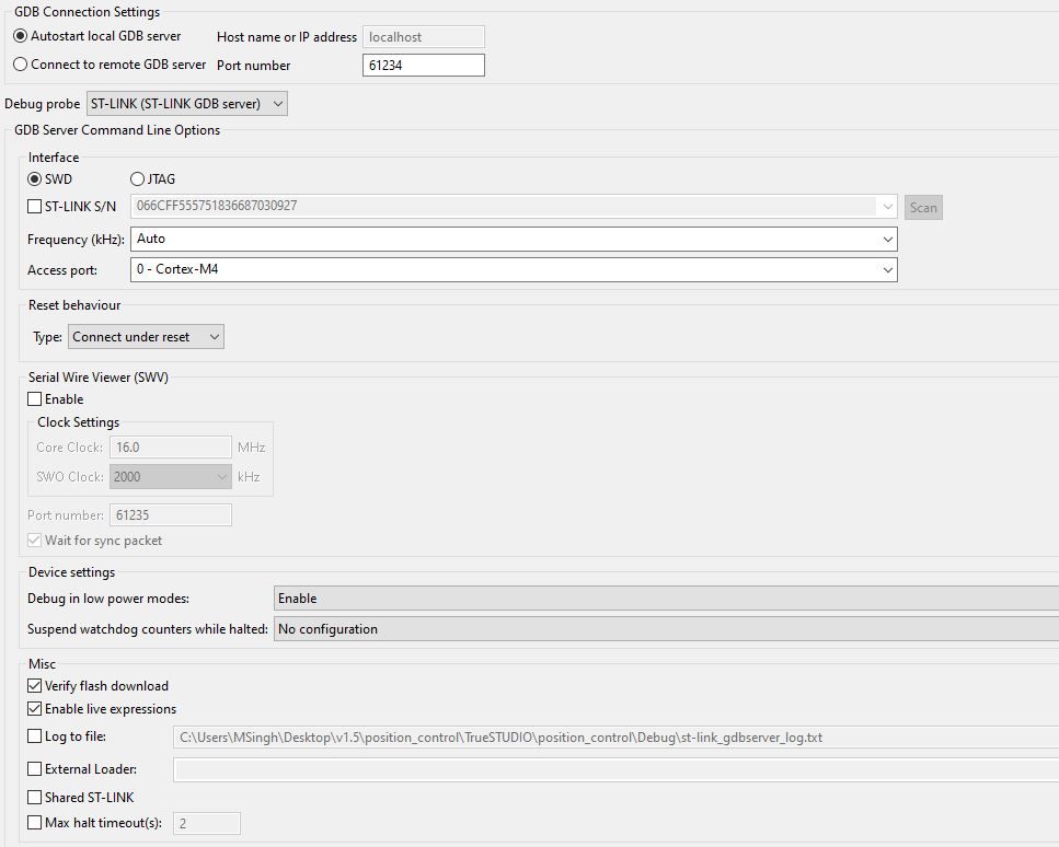

I do not see any PWM signals being generated I'm guessing that's the reason for it not to move? can the debugger configurations affect this? I had changed them to try implement printf. Here's what they look like now.

Did you try:
  • 1. to come back to the previous configuration of the debugger (just in case of)
  • 2. and to run you board without physical connection to the debugger
Best regards
