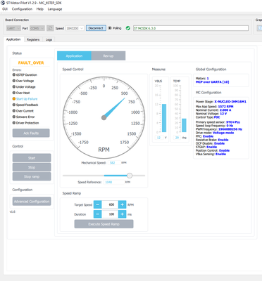

The P-NUCLEO-IHM03 with type selected as "FOC" has the firmware pre-installed. After pushing Blue start/stop button, the motor starts but fails to continue.
In Motor pilot, it is showing that a fault is thrown (startup failure) and the motor shuts down. The P-NUCLEO-IHM03 Black button needs to be pressed to clear the fault, but the motor still does not continue to run upon Blue button start.

2024-06-12 2:25 AM - edited 2024-06-12 2:28 AM
Yes i stator is fixed correctly.
Where is the option for reducing the target current to 1Amp in Motor Pilot (see screenshot below). I tried increasing ramp time but it didn't work.
I have already tried generating new project from MCSDK 6.3.0 many times but same issue persists.

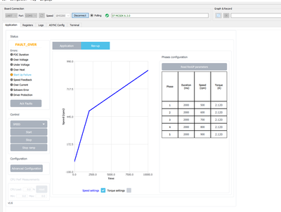

2024-06-12 2:58 AM - edited 2024-06-12 3:32 AM
It has started working better. When i feeded the table in revup section (see screen shot). But after reaching the last entry of the table, Pilot again shows Startup Failure. Whatever last value, i feed in the table it goes till it and then startup failure. Why so?

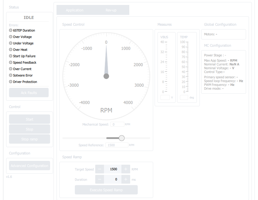

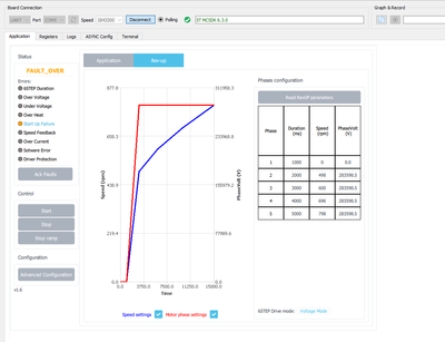

2024-06-12 4:35 AM
Hello tejas_amp,
The way I see things here, you have a 6-STEP project (or you loaded the MotorPilot with the wrong GUI), which is not the default setup of the IHM16 when shipped with a P-NUCLEO-IHM03. Have you checked that your IHM16 hardware is correctly set ?

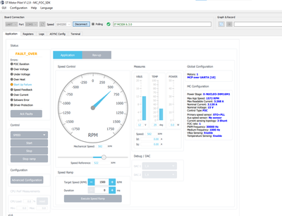

2024-06-12 4:39 AM - edited 2024-06-12 4:49 AM
Okay. I have loaded correct version now but still issue is same. Running till last entry and then startup failure. Please help.
When it reaches 900 rpm, it stops and shows startup failure.
2024-06-12 4:45 AM
Hello again tejas_amp,
Okay then could you try to Reset GUI to Default in the MotorPilot GUI tab, and then try the Discover Board button and then see how that goes please ?
2024-06-12 4:53 AM
Done. Please see edited reply above.

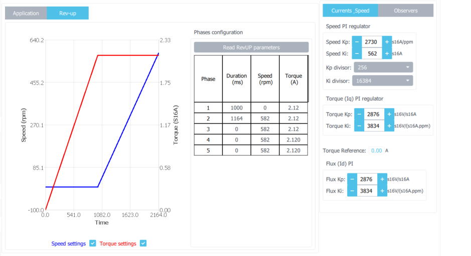

2024-06-12 5:19 AM
Dear tejas_amp,
The following setup is working fine for me, have you tried with something similar ? Don't hesitate to have a look at the Advanced Configuration.
You could also try to reduce the target speed to 400rpm (leave the first line at 0rpm, otherwise your motor won't align)
Another idea would be to increase the duration of the 2nd phase (1164ms one in my snapshot)
If this does not work, I would advise you to generate an Open Loop project (you can find the guide in the User Manual) and have a look at your Ia and Ib currents, it will help you determine whether there is something wrong with your HW, as the project should work out of the box.
