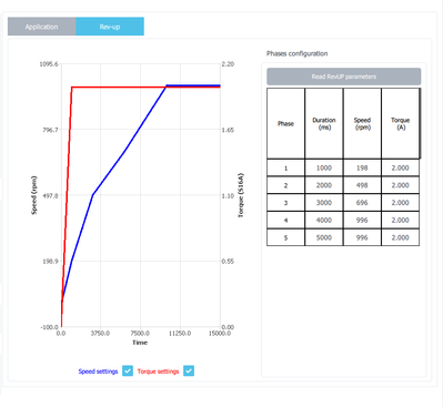

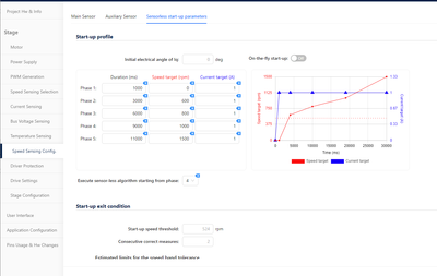

I have checked the Power Board three phase terminals in DSO, and its showing square wave for seconds under which motor is running and then it becomes Zero. What can be the problem here? The time and speed limit, I set in Speed sensing config, till that time and speed motor runs after that startup failure. (see screen shot). Also, I have tried varying every possible parameter but not getting result.

You can also try to increase the start-up speed threshold to 900rpm.
2024-06-14 1:27 AM
Current threshold = 100 rpm. I tried with 900 rpm as well but same results.

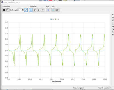

2024-06-14 2:11 AM
During start:
After few second fault:

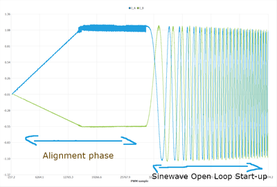

Okay, so obviously there's a hardware issue. You should have something like this :
Could you verify that the jumpers are set according to section 4.1 of the IHM16 User Manual ?
