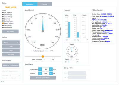

If yes then I saved it and used it for my project. I generated the code with MC DSK then ran it but nothing happens, so I opened ST motor pilot and saw that I'm having a speed feedback error :
What should I do?
2023-09-12 7:38 AM
I solved the speed feedback error by myself by filtering the noise that come with the hal sensors. I changed the capacitor associated with a lower value (from pF to nF). I'm working with 200 RPM max
