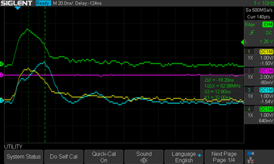

I believe that the wave forms going to the Gates is shown in this image, does this wave form look normal? The voltages are 2V at the peak but only about 10ns apart:

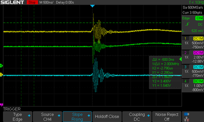

The phase currents are shown in this image:
All three phases are taking current.

I am thinking that I will need to change to a more suitable motor. The one I have is a bike motor that has 9 pole pairs and a max RPM of 285.

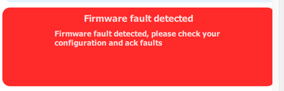

The motor never starts as I immediately get an Over Current error and "Firmware fault detected."
