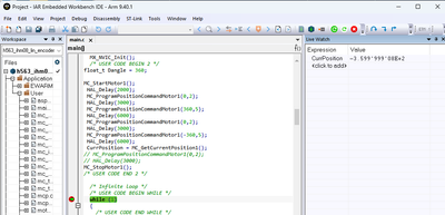

Hello! @GMA
I try your example with 200 rad. works. I change to 360 rad and it is not work. I add some logging to understand what happens between movements. I pin some screenshots.

Hello @ABask.1,
According to your logs, commands are correctly handled, but motor has not processed the number of rotations as expected.
Does your motor can spin freely, or is it connected to mechanical parts that could prevent rotation?
In your code, highest speed will be reach on 360rad to 0rad in 2s transition, that means 1718RPM, have you tested your environment in Speed Control mode and Encoder Speed sensing at such speed?
