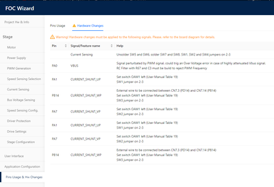

Hello @kumarairia,
You have to add an external wire between PB14 and PD14, as mentioned in the Workbench Pins Usage & Hardware Changes tab, which is not visible on slide 6.
If you agree with the answer, please accept it by clicking on 'Best answer'.Best regards.GMA
September 12, 2025
PB14 and PD14 are connected on the back side, I have soldered wire  there. Once I am at work I can send you picture.
September 12, 2025
Hello Expert,
PB14 and PD14 are connected on the back side of the board.
