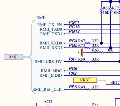

Hello fellow readers,
##Disclaimer##
I am using a Nucleo Board, the Nucleo H7S3L8, and HAL_ERROR ist laughing me since 2 days in my face#
I think you, dear reader, have heard about the SWR-Bit, which vanishes out as soon the software has restarted succesfully, everything seems perfect and you have finally the feeling you found the solution to world piece.
But I am currently at the brink of insanity, because this little ******* ***** ** **** wont clear itself after I forced the reset.
What do I mean specifically?

This section of code breaks me, and I know there have been a few posts before about it, but frankly they are either too old or my issue couldnt be solved by them.
But What have I checked so far? Many things. RCCs, the Ethernet control register and so on, but somehow i dont have a decent indicator why the SWR bit wont reset.
I also have modified my ethernetif.c and lwip.c according to the manual which is spooking around here, which is by the way behind a full driver update. As i am running my project not like a peasent only with Ethernet, instead like a meadiocre copy-pasta-champion with multible peripherals, the pin assignments arent the same as in the example or on Github.
So please, maybe one of you gods of embedded programming can help me free from my endless pain and torture to see HAL_ERROR every time again and wonder around in some driver files. I will append my ioc and my lwip folder, and hopefully you can point out simple and painfull easy error.

Hello @Vidar,
I understand your frustration. After reviewing your MX configuration, I noticed that your GPIO mapping for Ethernet does not align with the schematics for the Nucleo board. I suggest you try remapping the pins as shown in the screenshot below and try again.

Thanks so very much, I got the Ethernet working!
But honestly, why is that even possible? Shouldnt the RMII Pins be fixed for the Nucleo board? Even though there is no severe issue and you cpuld, including myself, RTFM, it would be way consumer frendlier if it would be fixed or an error occurred, as you can select the devboard in CubeMX?
