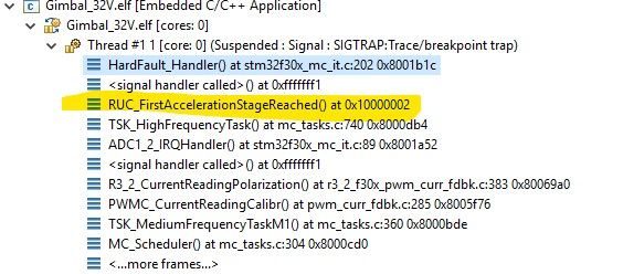

I did some tests using the MCSDK 5.4.0, I generated the project using MC WorkBench for TrueStudio and CubeMX 5.2.1.
The hardware consists of NUCLEO-F303RE and X-NUCLEO-IHM16M1.
The problem is the following: when I try to start the engine with WorkBench Monitor, the "Software Error" signal comes on:0690X000008ichgQAA.jpg
While the TrueSTUDIO debug hangs at the "HardFault" function:
Looking at the "Thread" we see that the function that generated the HardFault should be "RUC_FirstAccelerationStageReached":
But at this point I don't know what to do: I expected everything to work well without a hitch.

UPDATE: the same project realized with MCSDK 5.3.3 does not give problems. The engine runs normally.
Andrea
Andrea Canepa
Senior
June 17, 2019
UPDATE 2: the same project generated using the MCSDK 5.4.0 FULL does not give problems.
Therefore it is likely that the problem occurs with 5.4.0 when it is in normal version (ie not FULL).
