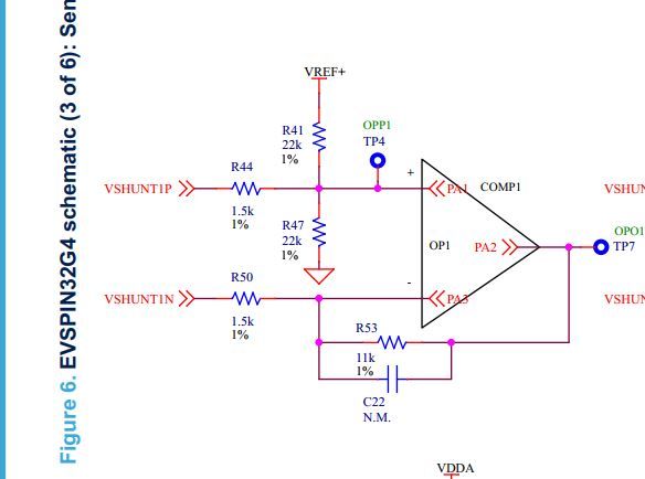

What's confusing about this is the way the EVSPIN32G4 hardware is configured.
Above is a circuit diagram for one of the three phases. To my eyes it looks like it is using the three internal opamps, wired differentially to three current shunts, using external resistors. Then presumably with the current shunts Kelvin connected to the opamp circuits.
This is not at all what's being talked about here nor is it anything like the configurations you can choose with the motor SDK. I also don't see how it's compatible, without any modifications, with the single ended PGA configuration you can choose in the SDK either.
Regarding the ADCs. From your description it implies that a single ADC could be used to perform all current shunt measurements but this would require the ADC in question to have separate input pins for each opamp. Something this chip doesn't have. Alternatively you could use two separate ADCs to perform the measurements but for this to work you need to be able to connect one of the three opamps to both ADCs at the same time. Presumably for some sort of calibration between the separate ADCs.
The configuration in the SDK, for the EVSPIN32G4, uses the two ADCs connected to two of the internal opamps. It then uses three current shunts. Shunt U and W have their own opamps but shunt V can be connected to either opamp when it needs to be measured.
